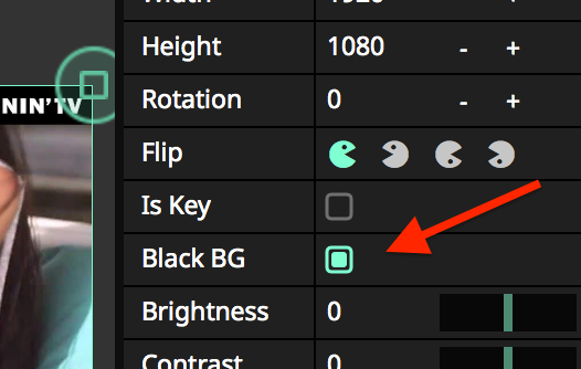

Resolume sends the stream with Alpha, looks like Realizzer ignores the alpha channel. Try playing a black solid in your bottom layer in Resolume, or enable Black BG in the advanced output for your NDI slice.

I've tried both the black still image on layer 1, and also enabling the black BG option on the slice in the screen sending to NDI.
If I now move the fader of the layer playing the video clip, then Realizzer follows the brightness properly for me with either.
Moving the composition master in Resolume fades to transparent, you're using that to fade the output.
BTW, in your video looks like you're trying to use the composition output, with this you should try the Black image on bottom layer, if you'd be using Advanced output to send your NDI, then the checkbox is an alternative.

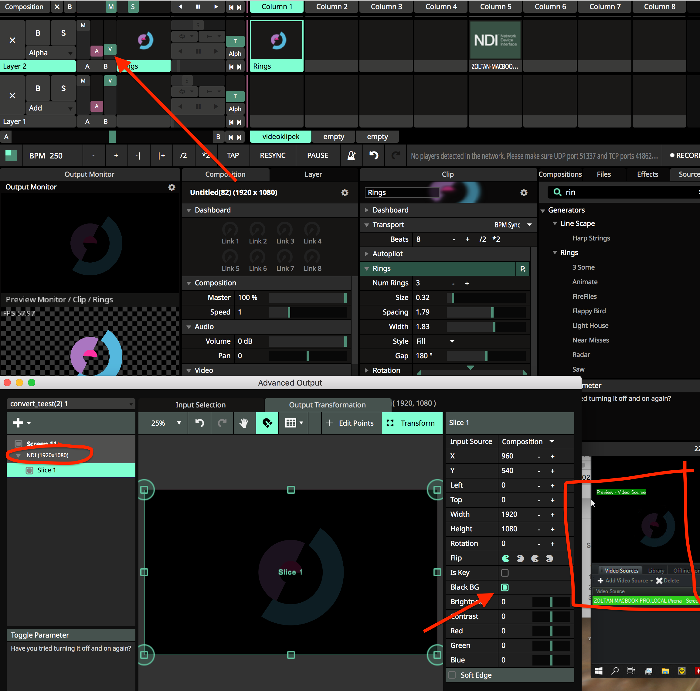

This is how it works nicely via the advanced output. On the bottom left you can see the Realizzer window.
