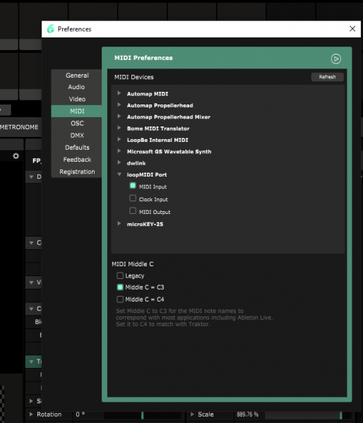

dave4pool
Posts: 6
Joined: Fri Jul 03, 2020 10:54
Re: glitches and lags when using midi cc internally
Post by dave4pool »
Hi, here's the screenshot of midi prefs, (note that all other midi controllers are all turned off) I'll send the log file from the auto email thing in preferences.

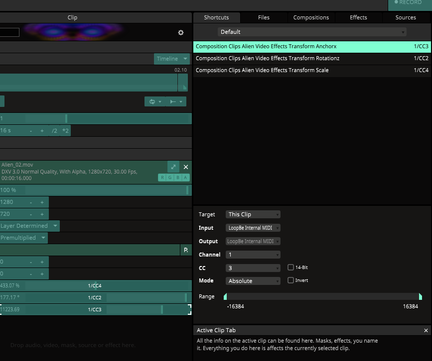

dave4pool
Posts: 6
Post by dave4pool »
Ok, I went ahead and installed Resolume 7, started a totally new comp (the default startup one), and just mapped the cc messages, nothing else. Same thing happens. I've attached the screenshot of shortcuts, and the composition file as well
Bug_fixing.avc
(330.75 KiB) Downloaded 251 times

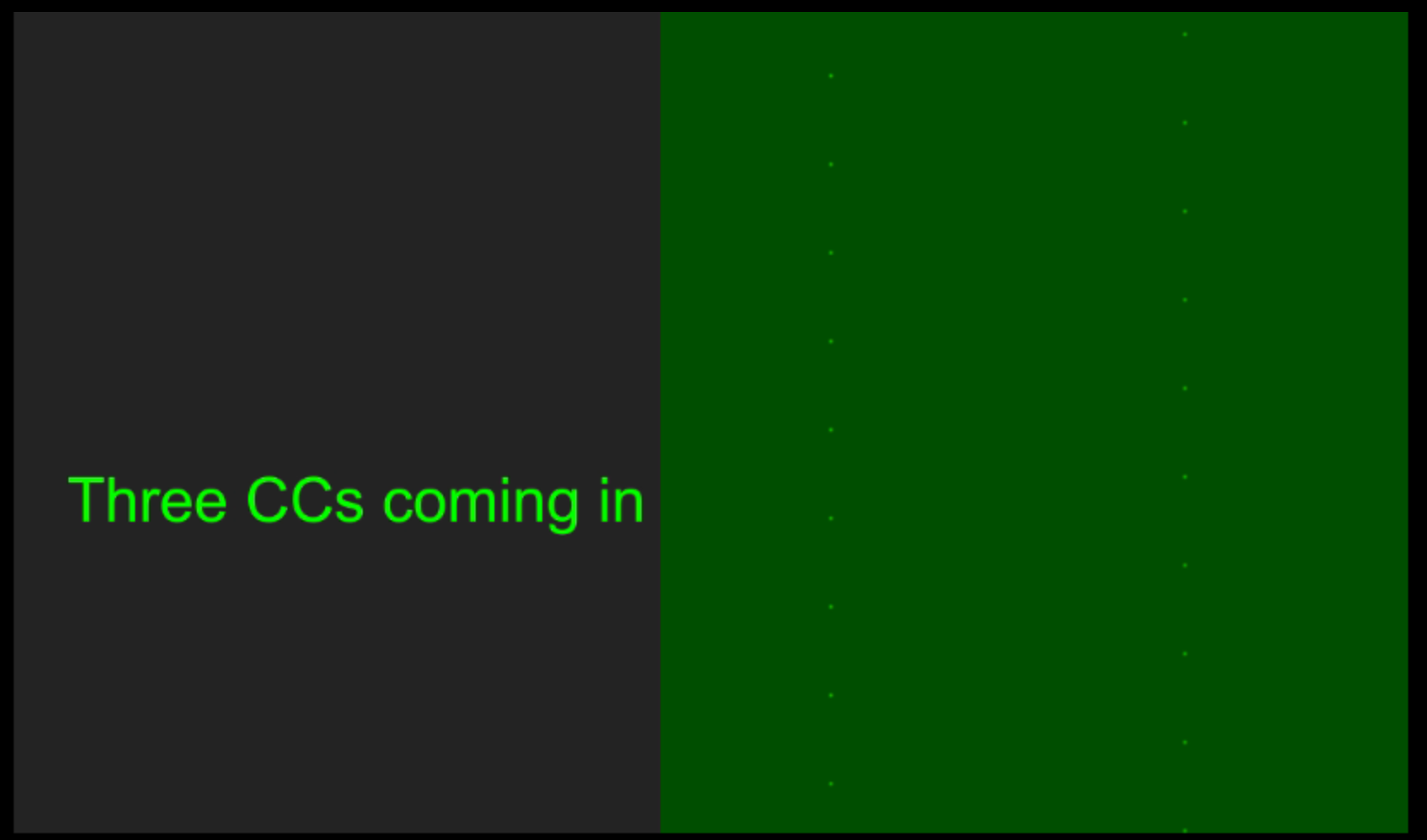

Posts: 7114
3 CCs from Ableton to Resolume works smoothly for me to both Resolume 6 and 7.
Can you try to send to another app or check the midi with a monitor tool if the timestamps are in specific intervals?
Do you see these glitches which are in your screen recording also on your monitor?
