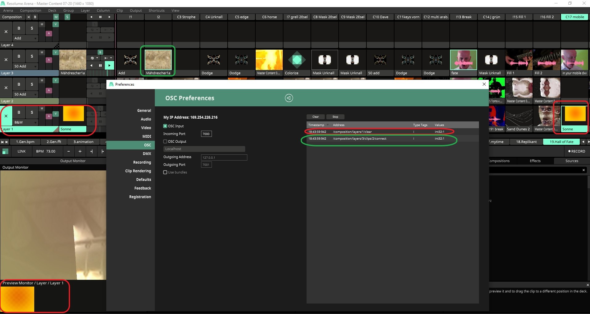

I want to clear a clip from layer 1 with this OSC command:
/composition/layers/1/clear 1
The "x" button of the layer is highlighted, but the clip is not cleared.

Does layer 1 stay this way for you for ever after these messages? I mean does the clip in layer 1 keep playing?

Re: clearing clip from layer with OSC doesn't work
Post by p8guitar »
Yes!

I found a ticket about this, we're working on it.
Looks like the layer clear breaks via OSC, if the button status is not set back via /composition/layers/1/clear int 0
Try sending the int 0 before or after the clear int 1-s

Great, with sending clear int 0 additionally, it works. Thanks! :-)
