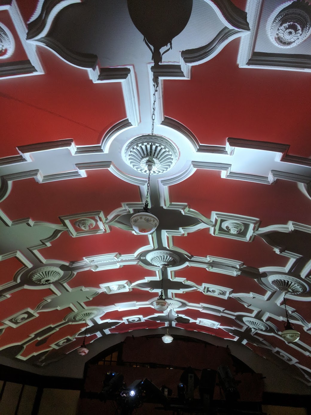

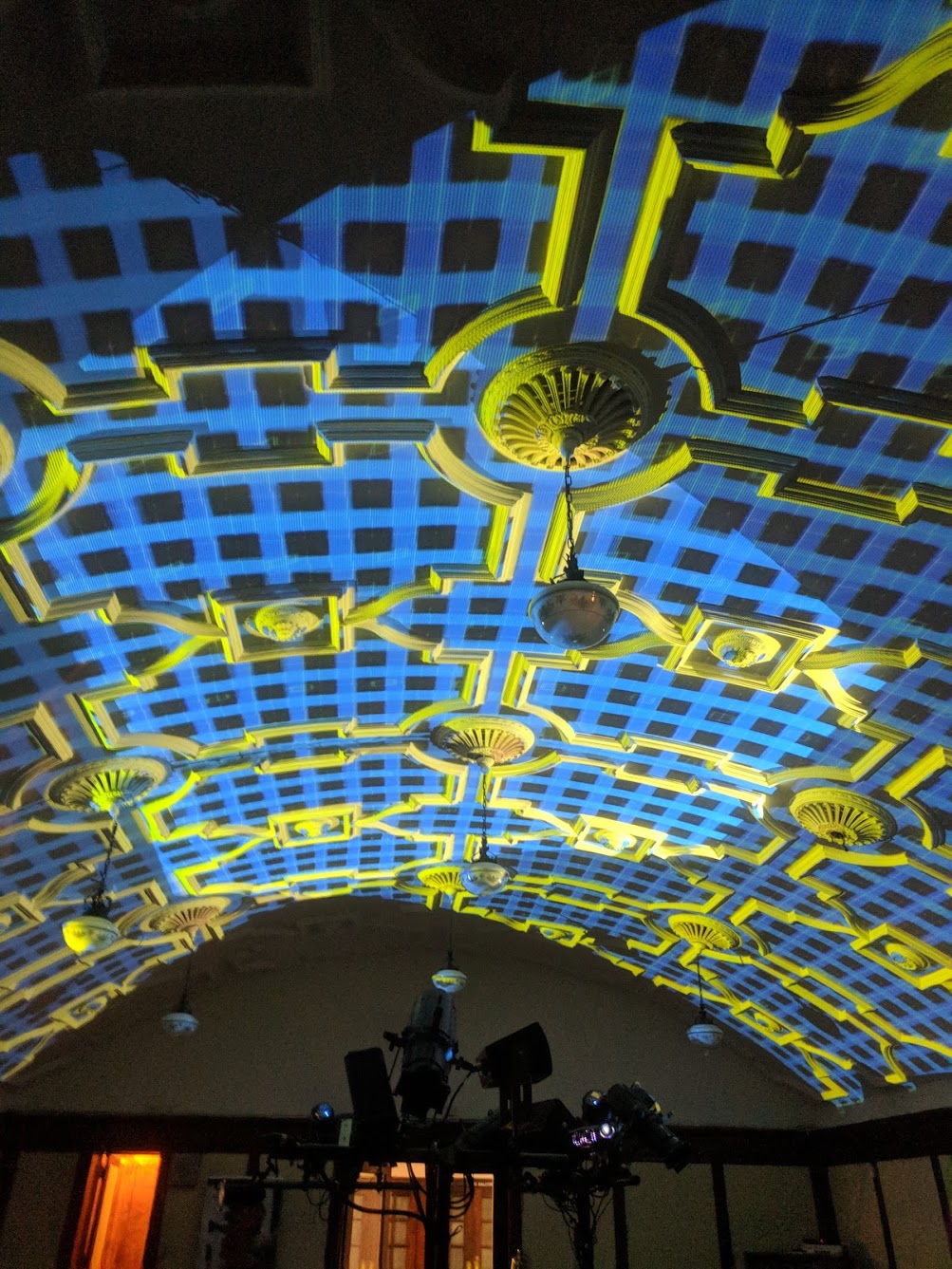

for more specific soft edge, I place a gradient generator set from black to transparent on a layer faded out. in Advance Output I create slices that only sample that layer and then edit the output points to create a very controlled blend. Attached is a sample of the mapping in resolume and one without the blend layer as well as the final and the final.
