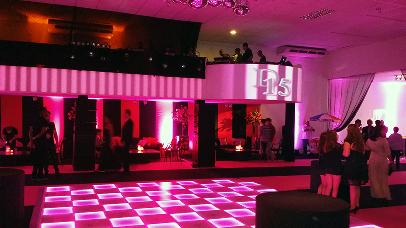

I am doing this today...
I need to project on this mirrors (painted in blue).
Actually they will be covered with a white adesive coating.
I only have one computer, two projectors, both with Wide Angle lenses (for the worst) and one analog triple head
My problem is the final resolution!
Each projector will be used for "one mirror leg". Imagine a Wide Lens image projected there. The loss of vertical pixels is HUGE. If I had 2048 pixels wide, I´d get only usefull 78 pixels in height.
To make it worst, as the analog tripple head has no software compatible with the mac, my max resolution is 800x600 pixels for each projector. That will drop my vertical resolutio to +- 60 pixels.
Yes, the content is very abstract but I wish I could make some scrolling texts as well.
Any advice on how to better set this up is very, very welcome.
tks
Paulo

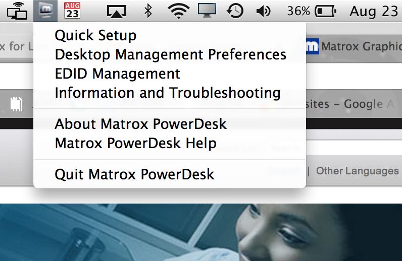

Nothing much that can be done about the pixel loss but you should be able to use your triple head on the Mac and choose 2048x768. I have the Matrox PowerDesk on my mac (and I run 10.9.4) and it works fine:
It's not easy to find on their site but you can download it here: http://www.matrox.com/graphics/en/suppo ... ad/?id=355
I also use SwitchResX to gain access to all the resolutions that are not always accessible with the display setting of the mac: http://www.madrau.com/ and you can program custom resolutions as needed. There is a 10-day demo so you can try for your show.
Good luck with your show tonight!

Thanks for the input.
Do you use the analog tripple head or any other edition?
I had installed the Matrox Powerdesk once. It did nothing, no change at all, as Matrox states no compability with the MacBookPro. (I guess all macs).
Mine works as plug and play, but resolution available is allways 2400x600 (limited as 800x600 each).
