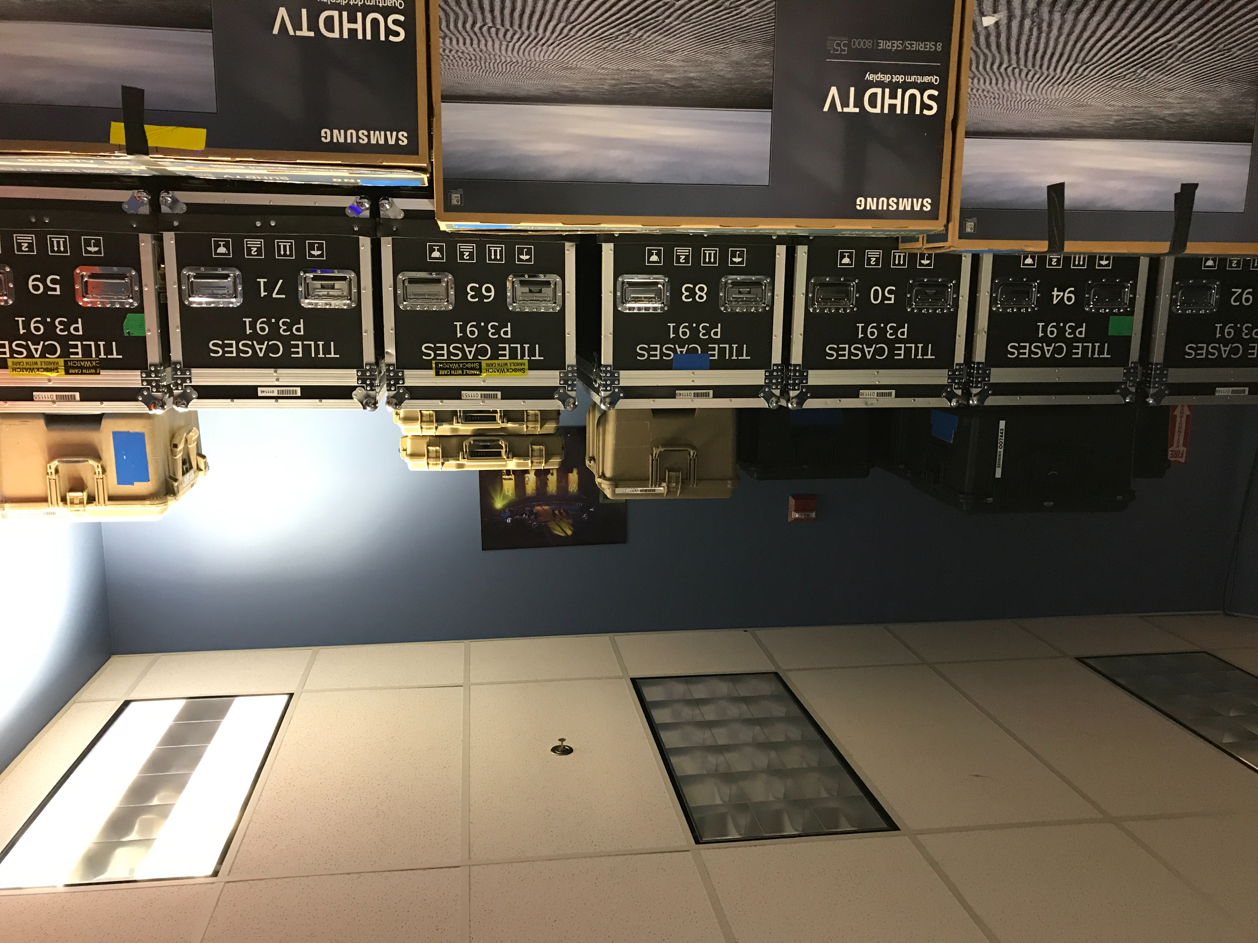

I have 400 panels of Gloshine 3.9. 128px x128px per panel. Out of the dozen different branded panels I have used, these are by far the best picture I have seen. Perfect image from any angle, even straight from the side. When properly bracketed together, you can not see where each panel begins or ends, even with pure white image.
I have had issues with handlers breaking the leds on the outer regions, so they are somewhat fragile if you do not have experienced help. Although I have never had an issue when I handle them myself during setup or strike.
http://www.gloshine.com.cn/en/product/list.aspx

cvanhoose
Posts: 277
Re: Artfox LED Video Panels? Or Other Suggestions?
Post by cvanhoose »
Plus they have nice road cases ;)
