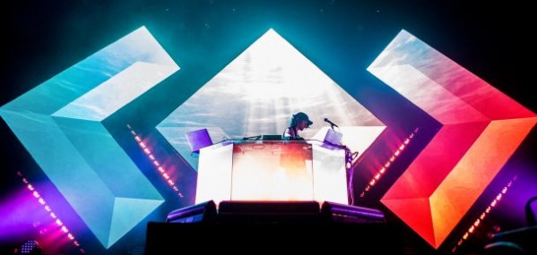

With an on stage setup that baffles even the best in the business, this 22 year old producer has reached where he is because of his focus on the audio-visual aspect of a performance, as a unit.
His stage setup should be trademarked. It’s a diamond with arrow- like shapes on either side.
All made of LED.

The show is run on two laptops which are on stage with me.
One runs the audio side of things in Ableton and sends MIDI through ethernet in real time to a second, dedicated video laptop running Resolume.
I have two Novation Launchpads to play musical parts and modify existing stems, one Novation Launchcontrol XL to handle some additional fx and general controls (including tempo) and a Korg SV-1 keyboard.
There is also a Xone K2 plugged into Resolume to control some video effects.

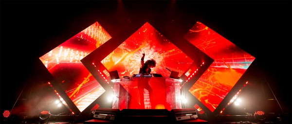

It's intuitive and powerful, the effects are extremely usable and the latest updates in Arena 5 added mapping options that enabled my latest "diamond/chevron" LED setup.
