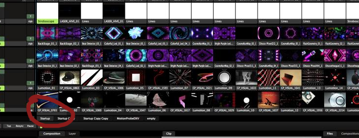

So to put things in perspective, and hoping to learn more and more from you guys, here's the setup of my resolume..
It's a lot I know, I use standard 5 layers, with the 6th reserved for logo's and DJ names, mostly the layers are filled until column 40 or 50 or so, I have preprogrammed and mapped 21 effects and mostly everything is set to 1024x768, the fifth layer is reserved for the resolume built in stuff, lines, flashy bars, beat driven squares and crosses etc. the other 4 layers are filled with loops and here is where my buddy and I have a big discussion going, I carry with me around 9000 loops on my hard-drive, of course I don't use them all but they are there so in my mind, resolume just reads the clips who are loaded in the deck and the rest is ignored until I load them into a deck, where my buddy thinks resolume keeps scanning this collection of loops over and over again when the loops I use are needed to play and this would be so much that resolume decides to go f*ck yourself and quits
So am I pushing my machine to hard? Should I cut on the number of FX? Is there something I should do different? Of course all loops (well most of them) are in DXV and I use big folders, not 5 loops a folder but 40 or 80 or sometimes more but also sometimes just 6, is this something that drives resolume crazy?
One more thing, the FX I use are always on the whole composition, only the built in generated visuals use FX on the clip....
