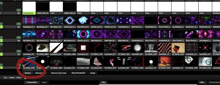

In this picture...
...it looks like you have 200-300 used or unused columns. Resolume can crash with to many used or unused columns. Every time I ran to it, because I flooded my deck...I deleted every unused column behind my clips and checked if it run stable. Saving and loading a composition with to many columns or clips mostly crashes Resolume. After thinning out my set....it works perfectly!
You can not delete several columns at once....only one after the other :cry:
That's my first guess!
