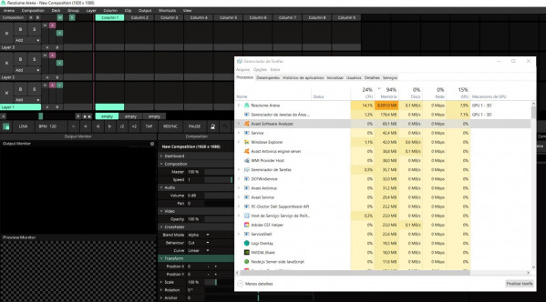

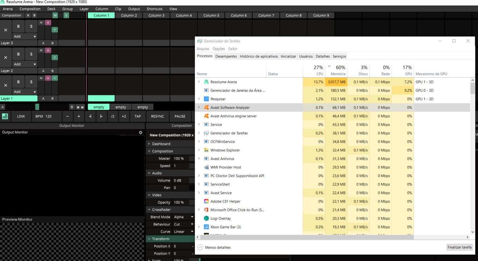

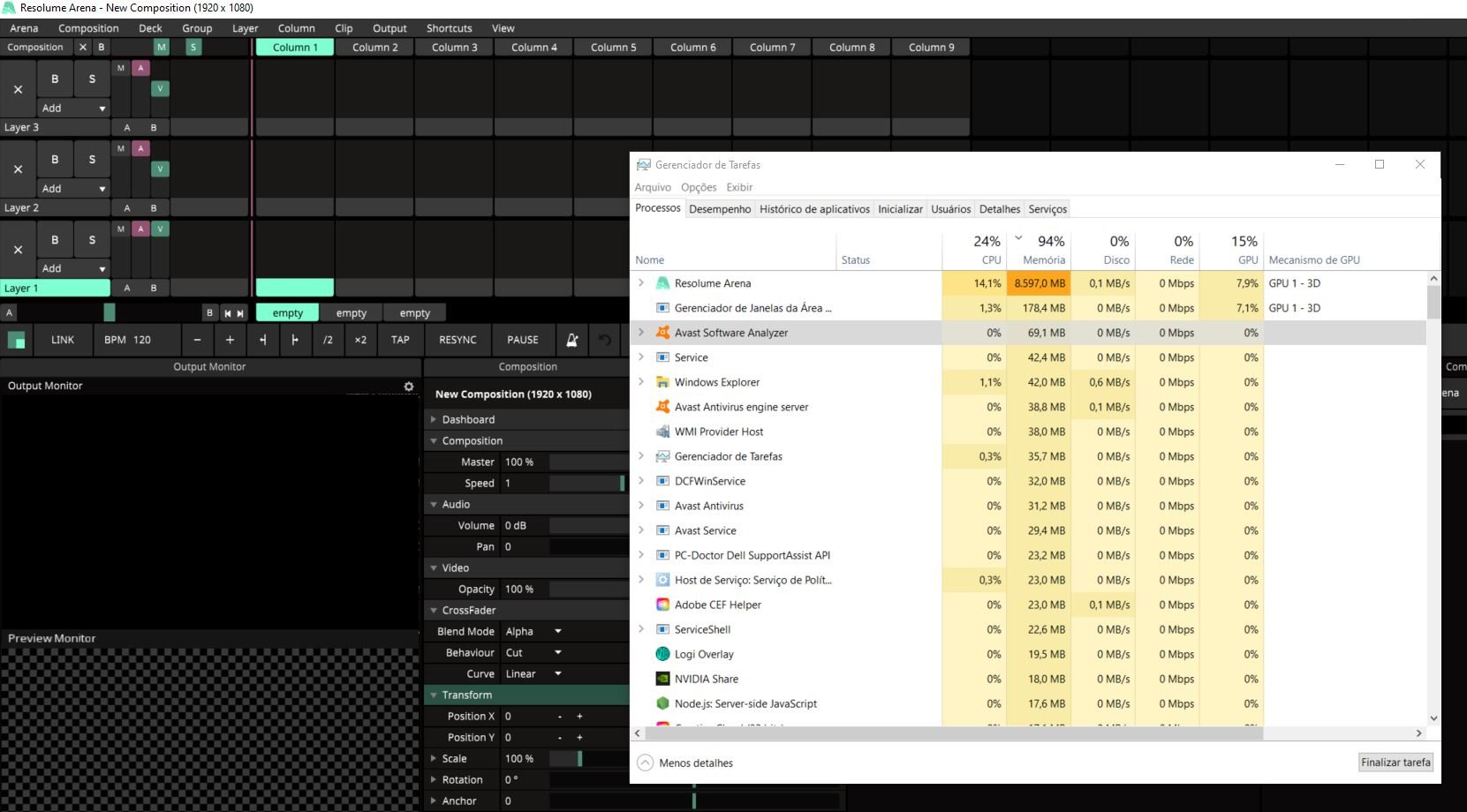

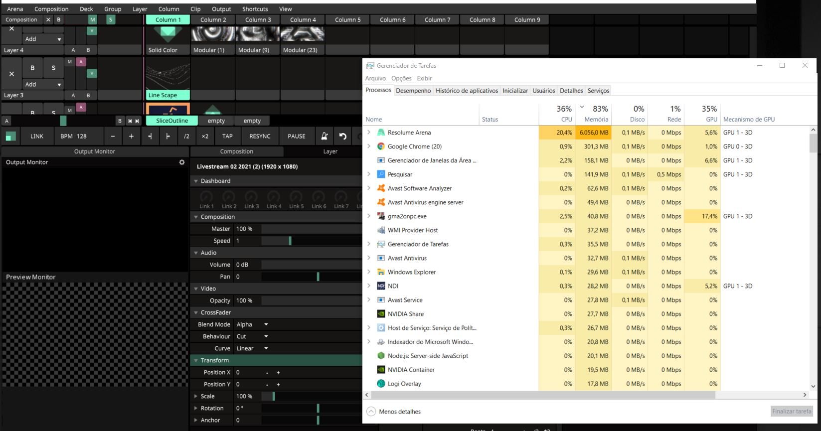

I have a Dell G5 with I7 9750H + 16 GB RAM + SSD 512 + Nvidia RTX 2060 6 GB running Windows 10 20H2, I noticed that Resolume memory consumption still increasing even if there is no clip Running.
See screenshots made when a Clip was running and them 10 minutes after I closed all Clips.
Information all clips were converted to DXV3.
Any idea what causes it ?
Thanks in advance.

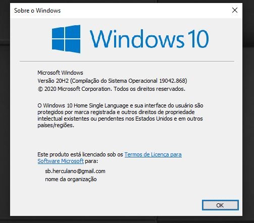

Which Resolume version are you using?
Do you also see the memory increase without any third party effects loaded, like the Slice outline?
sergioherculanomusic
Posts: 8
Joined: Mon Apr 22, 2019 18:46
Re: Resolume Memory Comsumption increasing
Post by sergioherculanomusic »
Hi Zoltan,
I am using 7.3.2 and even with an empty composition the memory still increasing see a new test with an empty screen after 20 minutes the memory increased almost to the maximum.
Resolume Version.JPG (17.71 KiB) Viewed 6184 times

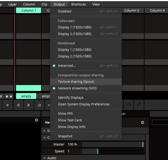

Problem it seems to be solved, the problem was related with Spout Output, I did several tests and when I deactivated it the memory comsumption still stable at low level
Posts: 7742
Sounds like spout is set to dx9 mode. If you disable dx9 mode using Spoutsettings.exe (which is part of the spout installer you can get at https://spout.zeal.co/ ), the memory leak should not happen.
