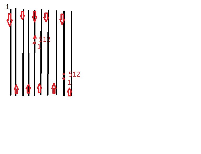

The first thing to introduce myself. My name is Pablo. I will try to learn from you. I have made several led screens with the w2811. They are in a nightclub and the Jinx Program is being used for control for ease of use. The surface of the screens will be increased and new effects will be created in local central columns. Due to the fact that you want to synchronize all the projections and the sizes of the zones are different, the current program, jinx, falls very short. And we had thought of Resolume or Madrix. Best in Resolume.
Attached drawing to understand how the led lines are, how they end and where the next one begins. Does Resolume allow you to make a screen like that? What I can't see in any tutorial or video is how to finish and start in the middle of one of the led strips on the screens. I don't know if it's possible? The controllers are the H802RA
