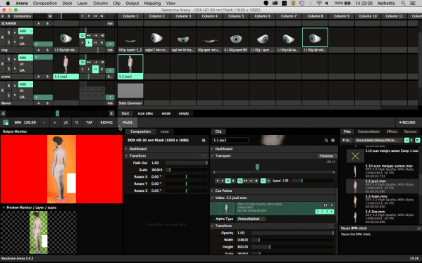

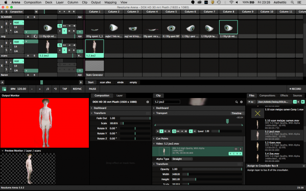

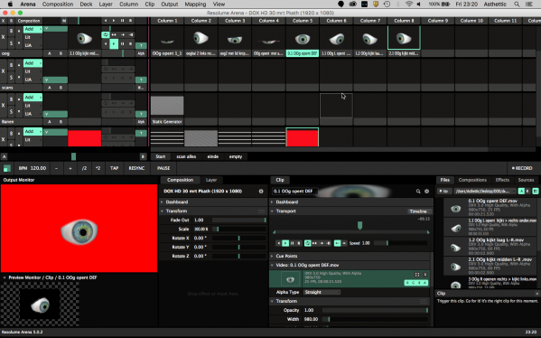

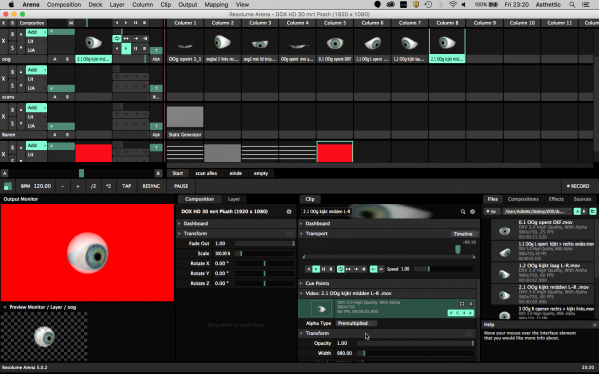

As promissed some fullscreen shots
Big thank you again, understanding alpha better helped loads; looks like all is working ok now.
I exported my clips alpha 'straight'.

adjusted the clip setting to straight. It seems to be premultiplied as default (maybe a nice option for the defaults preferences in an update?
In Preview alpha is still black , but the clip triggers fine now
- export straight, clip setting straight. preview = black, trigger = fine
- greenscreen (masked out in photoshop) straight-straight : no problem
btw when my clip is exported straight & left on the default setting premultiplied, I still see the part that I had masked out completly in Ae. Same goes for the greenscreen & random white bits that were never there before export or outside of resolume.....
Without it being an issue, still finding that kind of hard to understand..?
- export: alpha straight; default setting clip = premultiplied. Strange to see what I masked out came back
- same file but default clip setting still in premultiplied (hello greenscren & white debris?)
Thank a lot for all you comments & help guys!
