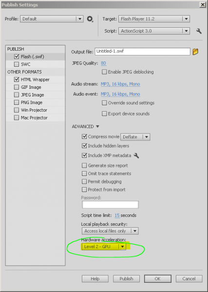

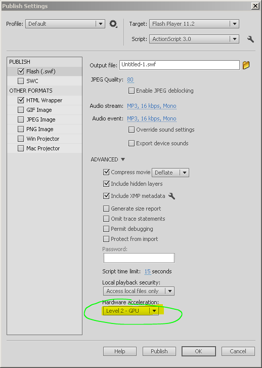

The issue is; not being able to run stage3d within flash files in resolume -e.g.Away3D
Flash has the option to publish in different hardware acceleration modes as seen below.
So you can get hardware acceleration, just not using stage3d.

As far as I can tell though Away3D still uses Context3D whether it's renderMode is set to gpu or direct. You can fallback to software rendering but that kind of defeats the point.
My guess is that dirtyjohn_lv is correct and we would have to change the flash params to give access to gpu/direct (I think this allows the flash player access to the GPU hardware and that's why Context3D isn't available here). But even if they were set I'm not sure whether this would enable direct access via Resolume as there may be other conflicts with access to the gpu hardware.
For now I think I'll order a Blackmagic Intensity capture device and run my particle fx from my GPU via that and into Resolume on my laptop. That should do the trick nicely.
