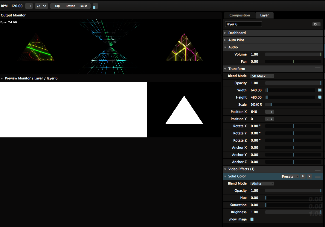

To make the other layers visible, you'll need to somehow make the areas outside of the clip white. There's two ways you can do this. One is pretty straightforward, just re-render your mask clip on trips resoluion on a white background.
The other method is quicker, and doesn't require re-rendering. Apply a Solid Color effect on the mask layer. Switch the render order of transformations and effects. Now set the Saturation value to 0 to make the Solid white, and toggle Show Image to bring back the original clip on top.
Hope that helps....
