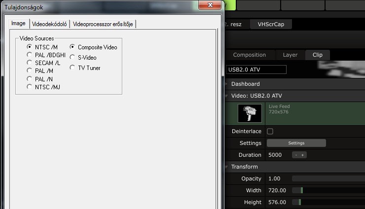

try to switch from NTSC to PAL
if you are on PAL, then to NTSC.
you should have a device control panel button in the clip
edit:
actually it is called Settings
the control panel for my easyCap looks like this:

Thanks!!!
It would never occour to me to look after some config on clip´s properties.
Now it is perfect! 100%!
