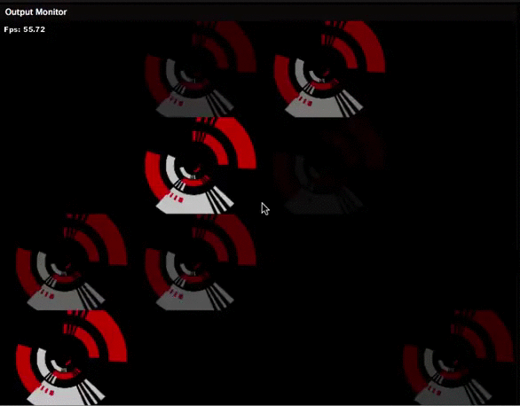

Re: How is this done?
Posted: Wed Nov 05, 2014 16:01
by Tecno`
I have used also used the video wall effect before to do something similar.
The great thing about it is that you can set the border thickness, how random the image is distributed across the squares and brightness variation between squares.
I seem to remember that the aspect ratio of the individual squares is based on the image or layer size that the effect is applied to. I think I got round this by using it as an effect clip and adjusted the size of that.
I pictures above shows using the effect (not the best photo) and then the surface can also be used without the effect
