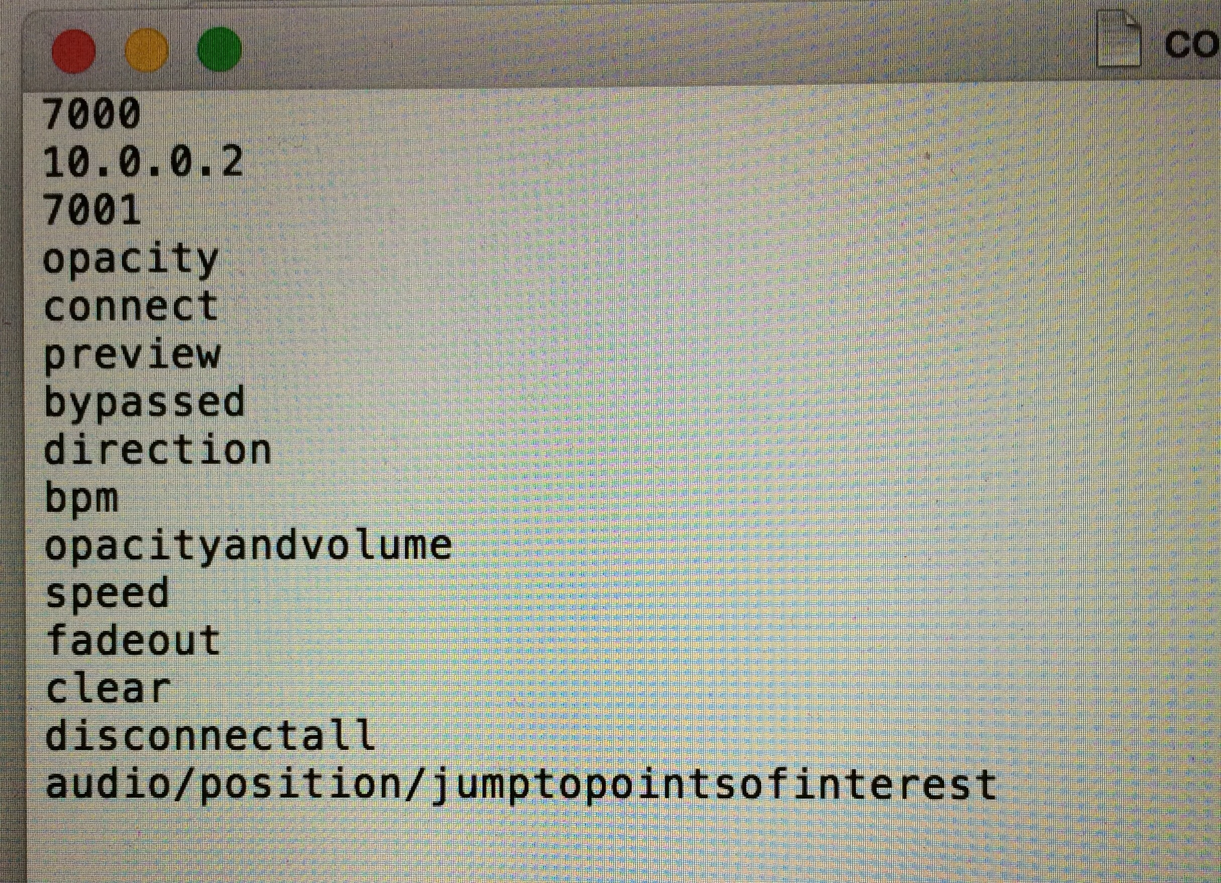

This is the white list of osc commands my master Arena composition sends to slave Avenue computer:

Additionally "junptothepointofinterest" restarts a clip when it's simply selected on the other computer. A bit unexpected behavior as I thought it was a command for "cue point" (I copied it from cue point trigger). I thought that only pressing that trigger would send this command, but somehow simply selecting the clip does as well.

zebbler wrote:Additionally "junptothepointofinterest" restarts a clip when it's simply selected on the other computer. A bit unexpected behavior as I thought it was a command for "cue point" (I copied it from cue point trigger). I thought that only pressing that trigger would send this command, but somehow simply selecting the clip does as well.
that us happening because, when you select a clip that is currently playing, it becomes the activeclip, and all the data regarding that clip will be sent over osc twice, once as layer/clip/ and as activeclip/ too.
this causes a lot of unexpected things.
that is why i am asking about your master slave config.
and if you send osc from the slave back to the master that will cause eventually a feedback loop.

I have a "white-list" OSC filter setup in Processing, so only the commands that I have sent a screen shot of - get passed through. Everything else doesn't.
Communication between computers via OSC is happening only one way - master to slave, so no feedback loops would be possible.
