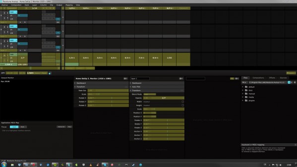

I have a problem with the Midi mapping of Resolume Avenue. When I want to edit the Application Mid Map I can't map every layer. There is only layer 1. Please look at the attached picture.
I had to reinstall Resolume and before that the mapping was just fine.
By the way I'm using an APC 40 MKI.
I hope you can help me because it's driving me crazy;)

From the midi chapter in the manual: https://resolume.com/manual/en/r4/controlling#midi
MIDI mapping works very similarly to Key mapping (above), so it’s a good idea to read that part as well if you haven’t already. It explains the difference between Application and Composition mapping, and the ‘layer’ and ‘deck’ focus.
Tip! Read the Key mapping paragraph. Even if you just want to map your shiny new midi controller, it has essential info for all mapping modes. You don’t want to come across like a noob because you don’t know how to map all the layers, now do you?
Re: General Midi Mapping Problem
I totally missed that option
Thank you very much!
