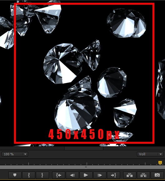

Set up an empty project and add the footage you would like to scale to your timeline.
Add a frame on top of your footage with the dimension of your LED wall....in this example is has 450x450px:
Set the scaling of your timeline preview and the playback quality to 100% and be sure that you see the whole frame.
Mostly all LED systems have pretty good contrast abilities...so to get as close as possible you can ++ your monitor contrast too.
Now you can scale your footage under the frame...and look how it behaves.
unscaled scaled
unscaled scaled
