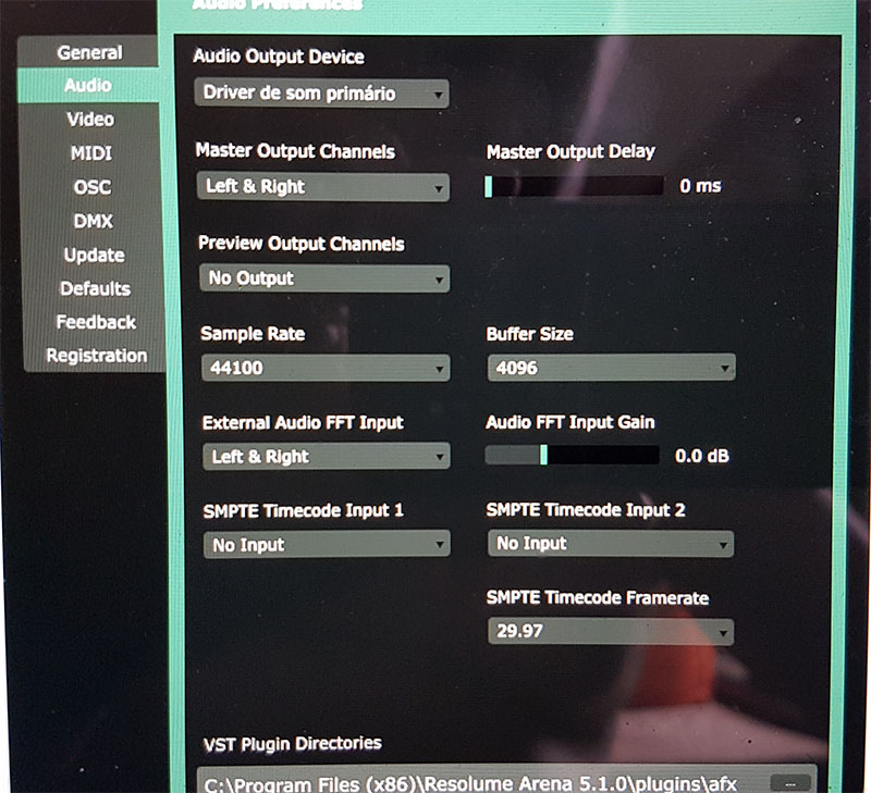

Could you post a screenshot of your audio preferences, please?

Joris wrote:Could you post a screenshot of your audio preferences, please?
Re: Audio Pitch: Timeline vs. BPM
Posted: Tue Oct 11, 2016 10:01
by Joris
That's a really high buffer size. Could you try decreasing it to 2048 or 1024?

Joris wrote:That's a really high buffer size. Could you try decreasing it to 2048 or 1024?
I just started the system to try changing this value but guess what.... What??? All videos were just playing nicely on timeline mode. No adjustments. Pure magic.
So I will have to wait for another issue to happen to test changing buffer values.
