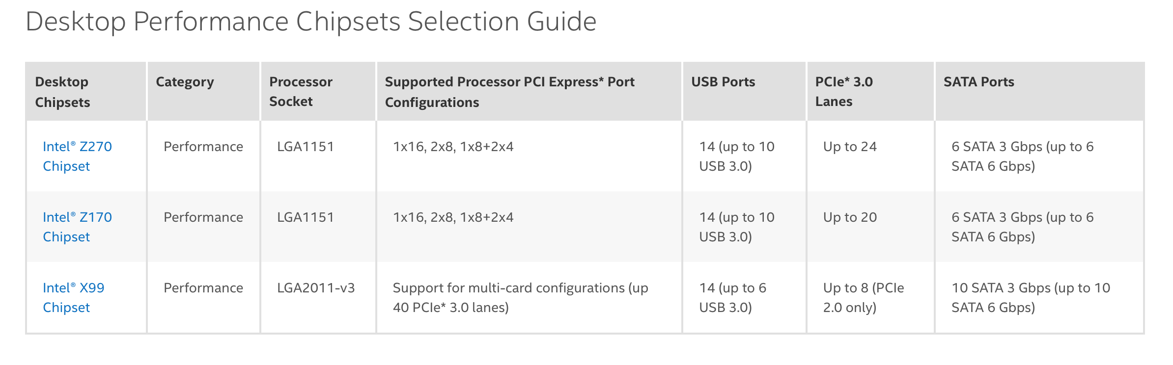

First, Z170 and Z270 are not laptop chipset.
Second, Z170, Z270 AND X99 chipsets are considered "performance desktop chipset". X99 is not more "professionnal" than the Z170/270. It's not a Xeon server-class chipset.
Third, I will let that picture from Intel speak by itself.
Both chipset are on this page:
