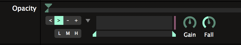

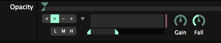

Can you confirm that you've got full dynamic range in your external FFT animation settings?
and not just the low end
To access the menu, click on down arrow next to + sign.
