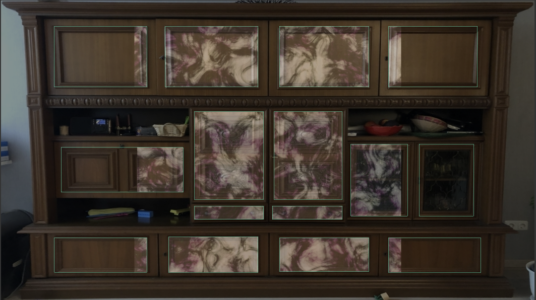

				Hi there,
I'm trying to do some blinky slices with Slice Transform.
When I apply the blink sequence (slice a, than slice b+c, than all, ..) direct to the clips, lets say 8 clips for an 8 step sequence, it works fine for me.
But when Im trying to split content and blink position for more flexibility I have an issue.
My idea was to combine my content from layer 1 with a mask layer above using slice transform in that layer, but I get a cropped result when using the mask scaling option.
Also with the other slice transform scaling options its seems wrong what I get, see below. Beside the wrong size its more like a cropped mask option shows the content behind, than a repetition of the same content in any slice as usual.
If I just use the effect layer (with deactivated mask option) the video is not cropped I get an overlay of layer 1 and 2. If 1 is dark, there is nothing the effect can use. hmm
Thanks a lot for your help <3

I've found one more thing while playing with the "slice test". see below

				The first thing to keep in mind when using Effect Clips, is that the transparency and render order of the layers come into play. The visual result of an Effect Clip is different from the same effect applied directly on a clip or layer.
When applied on a clip, the result of the effect replaces the original clip. When applied as an effect clip, the effect renders on top of the result of the layers below. So if you have transparency, you will see the layers below, and then the result of the changes made by the effect on top of that.
So in this case, this is expected behaviour.
In the case of the Slice Transform, you can enable the Black BG toggle to render the result of the effect clip on black. You can also place a Solid Color effect at the end of the effect chain of the Effect Clip, with its color set to black and Show Image enabled.

In fact: Using the Black BG toggle I get the result I'm looking for <3
