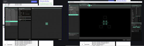

So I've got a couple of fixtures which have what I'm guessing is an unconventional DMX channel layout.
Here's a link to it: https://imgur.com/a/Gkl4KT8
I've tried to recreate these fixtures in the Fixture Editor of Arena 6 and I can't figure out how to do it.
There are parameters in this configuration that are interspersed with the RGB elements and if I was able to add more than one pixel block it'd be pretty straightforward to do this.

I came here to ask for this, I see that other people want the same thing. Currently, when I patch a fixture that has a bunch of different parameters I end up making 2 or even 3 fixtures and carefully setting their DMX channel start numbering to make sure they are contiguous. This works, but it's a huge pain. As a practical example, I have an LED bar that uses 3 fixtures in Resolume right now:
  • ch1-9: Luma samplers for controls like dimmer, strobe, pan, zoom
  • ch10-22: RGBW samplers for main LED colors
  • ch23-32 Luma samplers for additional LED controls (patterns, strobing, etc.)
In addition to these 3 fixtures, I have 3 more fixtures that use sliders to manually test these parameter values, and I switch back and forth as needed to be able to manually test the DMX values to figure out what works and what looks good.
In an ideal world, I would love for a single fixture to be able to have arbitrary numbers of manual sliders and pixel samplers so we can drive some parameters with Resolume tools and have others explicitly pixel mapped using whatever combination of Luma, RGB, RGBW, etc., each with a manual override so we can quickly test and diagnose issues.
