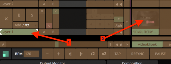

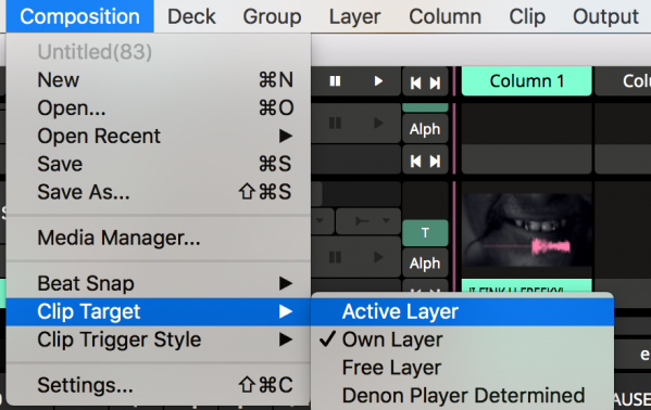

Folder / file method is not supported currently in Resolume.
If you already have your clip loaded in a deck, you can select and launch it via Art-net.
There is the Active layer Clip target option you can use to launch a clip in a specific layer.
First you'd select a layer, with a shortcut assigned to the layer name handle

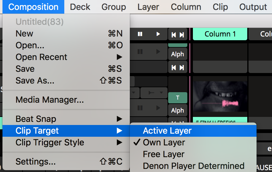

then trigger the clip with another shortcut.
