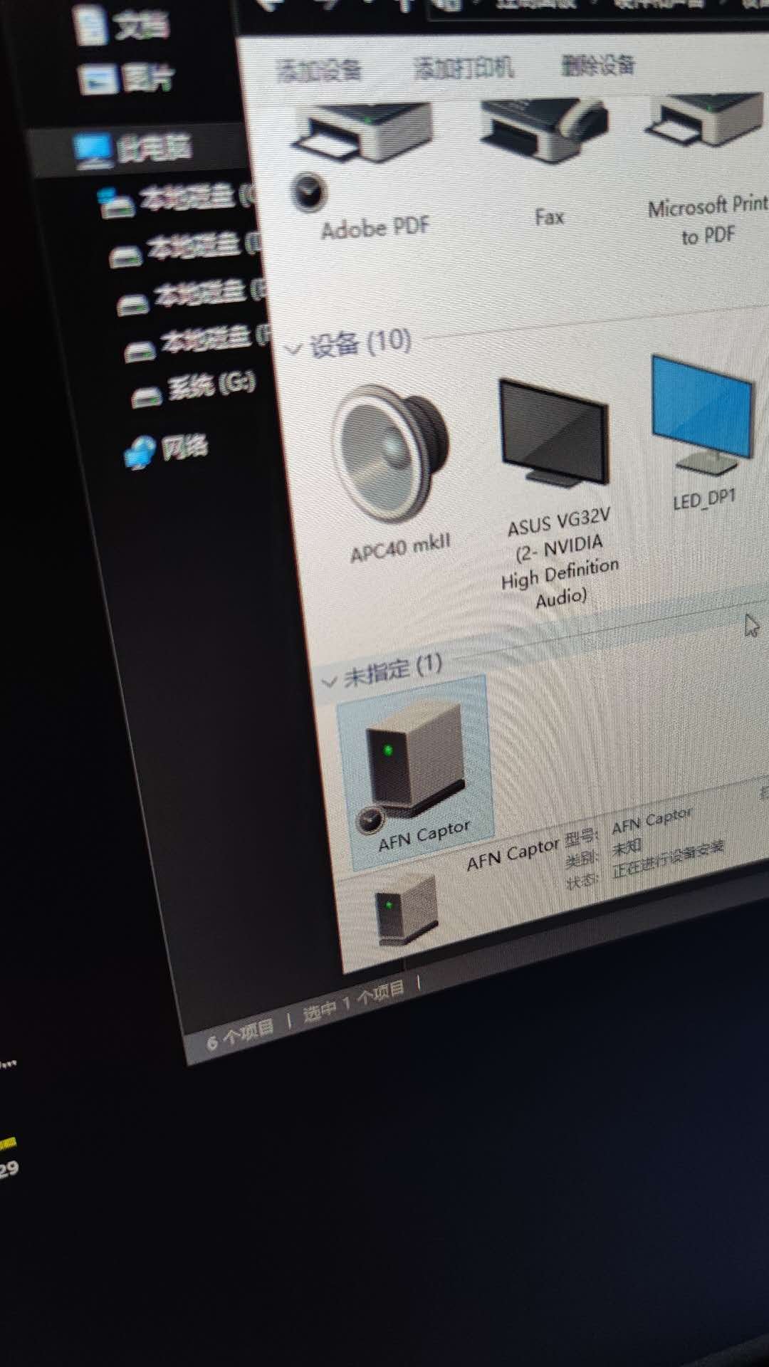

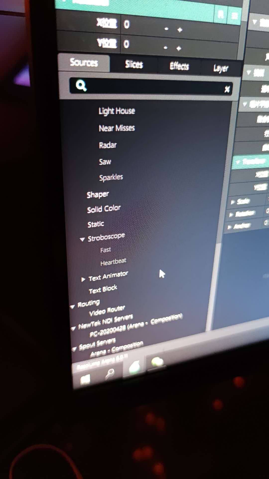

Thanks for the reply. Here is the strange thing. I downloaded the resolume arena demo to my laptop and plugged in the USB3 capture card. It worked just fine (Win 8.1). The capture card showed up in the sources panel near the bottom, which i then dragged over to the top layer in resolume arena. No issues.
Armed with that knowledge, I returned to the club, plugged the exact same USB3 capture card into their computer (Win 10), and .... it doesn't show up in the sources panel at all. I checked the device manager and it shows there. Why might it not show up in resolume arena at the club when it works just fine on my laptop? (I forgot to check the version of arena they are running). Any ideas??

Looks like Arena 6.0.xx
I guess you tried with 7.2.1.
The latest Arena 6 is 6.1.5, you can get it from the bottom of the download page. Could be also that the card doesn't work the same way as it does in windows 8, maybe it needs drivers after all.
Does it work in other apps on the win 10 machine?

I'd also check their USB ports are actually 3.0, as it's an older machine.
