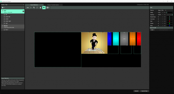

I think I am experiencing a Bug with this solution... :o Or just my missing knowledge...
I did everything like described above. It seems to work perfectly fine at a first glance. As soon, as I use slice transform weird things start to happen: The movement is applied relative to the Layer (which is smaller than the composition). This results the Videos not filling the slice. You can see, how everything should be in it's slice but actually moves relative to the smaller layer.

Is the slice transform before or after the layer's Transform?

Re: Auto resize to slices
Post by LukasGasp »
None either. I have it on the indiviual clips. Should I change this?
