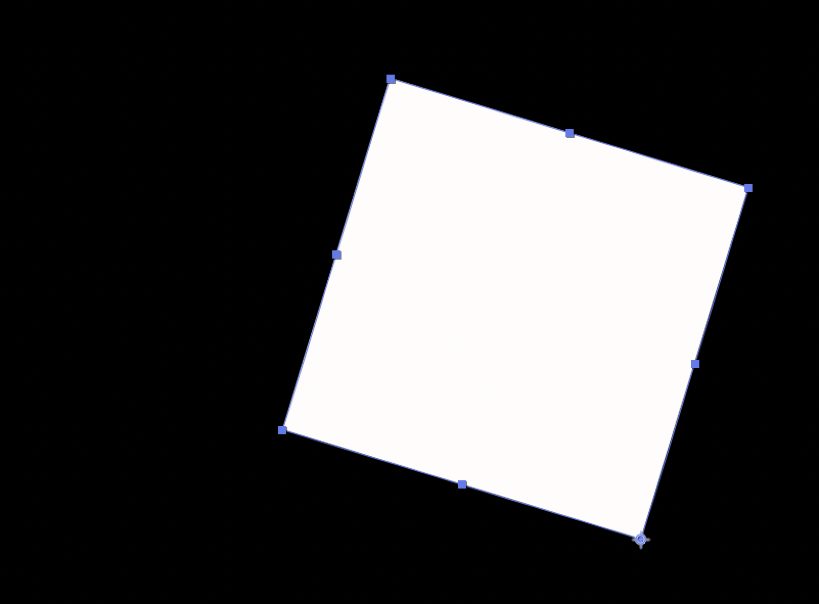

So for a while ive been trying this very simple thing: A square that is rotating (rather tilting) around its vertex/corner point. Something fairly simple in e.g. After Effects, see screenshot.
I would love to have it done in arena with a shaper and animated by FFT though.
But im already puzzled for a while how to make the Anchor XY work so i can rotate Z it. I thought i knew but I don't seem to get the principle behind the Anchor XYZ in Resolume apparently
Is there anyone with the golden tip?
(tell me I'm stupid, iif that's the case;)

The moment I start to adjust the position and scale, it also changes the rotation. Makes sense, but how to adjust the coordinates again so it gets back to one of the vertexes? What is the logical connection between the various settings? Is it the resolution or grid of the screen I dont get, or the basic idea of an anchor?
