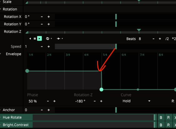

Good day guys,
I have a problem with the combination of random playback of the clip on BPM sync and effects that also run on BPM sync. The position of the timeline is always shifted one frame earlier before the effect is applied resulting in an unclean picture between the transition. I work with step envelopes for the effects. Please find attached a screenshot of my clip settings.
Best regards
Tobias

try adding a keyframe with a very short slope here:
Képernyőfotó 2024-04-08 - 15.50.51.png (48.38 KiB) Viewed 6117 times
The keyframe you have there is already on the next beatmark, you can also try to move it a bit before the 5/4 mark

Good day Zoltan,
thanks for your reply on my issue. Unfortunately the slope with another key does not fix the problem but worsens the effect. I still have this one frame where both effects (random playback + transform) are not in sync even after resyncing. Do you have any other suggestions for a solution? I have already tested all types of curves and different distances between the keys at the 50 % mark and always get a similarly poor result.
Best regards
Tobias
