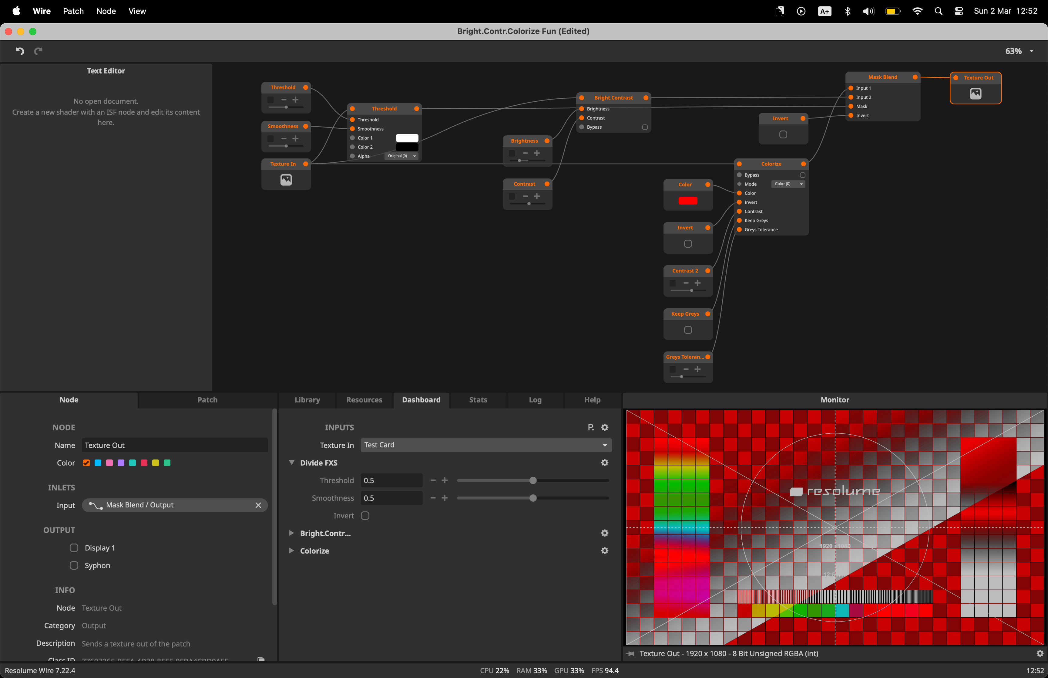

I'm not sure if that would give you much boost. Here is a plug-in for you to try. I just put the brightness contrast and colorize after each other so you could test.
Bright.Contr.Colorize.wired
(10.94 KiB) Downloaded 251 times
I think it's mostly easy if you combine effects, that you can make presets for all those effects together and easily switch presets for multiple things at the same time. But I'm not sure if it would give you much speed increase. And Wire is of course nice to make your own versions of the effects, do stuff with automation or combining things together in new and exciting ways. Like taking the two effects on top and combining it with a threshold will give you some interesting effects. Where one side off a threshold will get colonized and the other side will get brightness and contrast then stuff gets fun. Check it out.
Bright.Contr.Colorize Fun.wired
(11.56 KiB) Downloaded 243 times

tijnisfijn wrote: Sun Mar 02, 2025 12:56 I'm not sure if that would give you much boost. Here is a plug-in for you to try. I just put the brightness contrast and colorize after each other so you could test.
