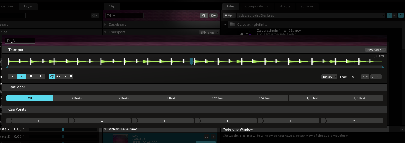

Is there any way to detach the clip transport control and then enlarge it to give a much longer length to scratch the animation / video to? Currently the length gives too fast a change on a longish clip and one can`t do very fine scratching. It could be an optional extra window that displays the transport for any clip selected.

Don't know if you found this already, but you can click the magnifying glass icon in the top right of the clip tab. This will expand the playhead, cue points and beatloopr.

And how to reset the view to the normal size of the transport cotrol ? As soon as I klick the magnifying glass, the expanded transport control covers the magnifying glass and I can not klick it again to reset the view.
I could not find a solution in the manual.

Ok, found it by try and error. With the ESC-Button it works. This should be described in the manual. This is a wink to the developers of the manuals ;) .

Good find. There are indeed a few screen configurations, when working with a lot of layers or a small laptop screen, where the popup can overlap the button.
We'll make a ticket for it, thanks for letting us know!
