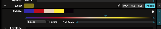

Options
Once a parameter has been added to a Dashboard, you get access to a few extra options.
Parameter In and Out point
Of course you can set the in and out point for the param. This will let you use the full range of the dial to only affect a small part of the parameter.
This is great for very sensitive controls, like the Global parameter on Twitch. Especially when combining multiple parameters together.
Invert
Make the parameter move up when moving the dial down and vice versa.
Dial Range
This is an interesting one. You use it to set which range of the dial controls this parameter.  It's like the inverse of the parameter in and out point.
For instance, by setting the out point of the Dial Range to 0.33, the first third of the dial controls the full range of the parameter. You can then use the remaining 2/3rds to control other parameters from the same dial. When combined with the Invert option and the parameter's own in and out point, this gets really freaky.
