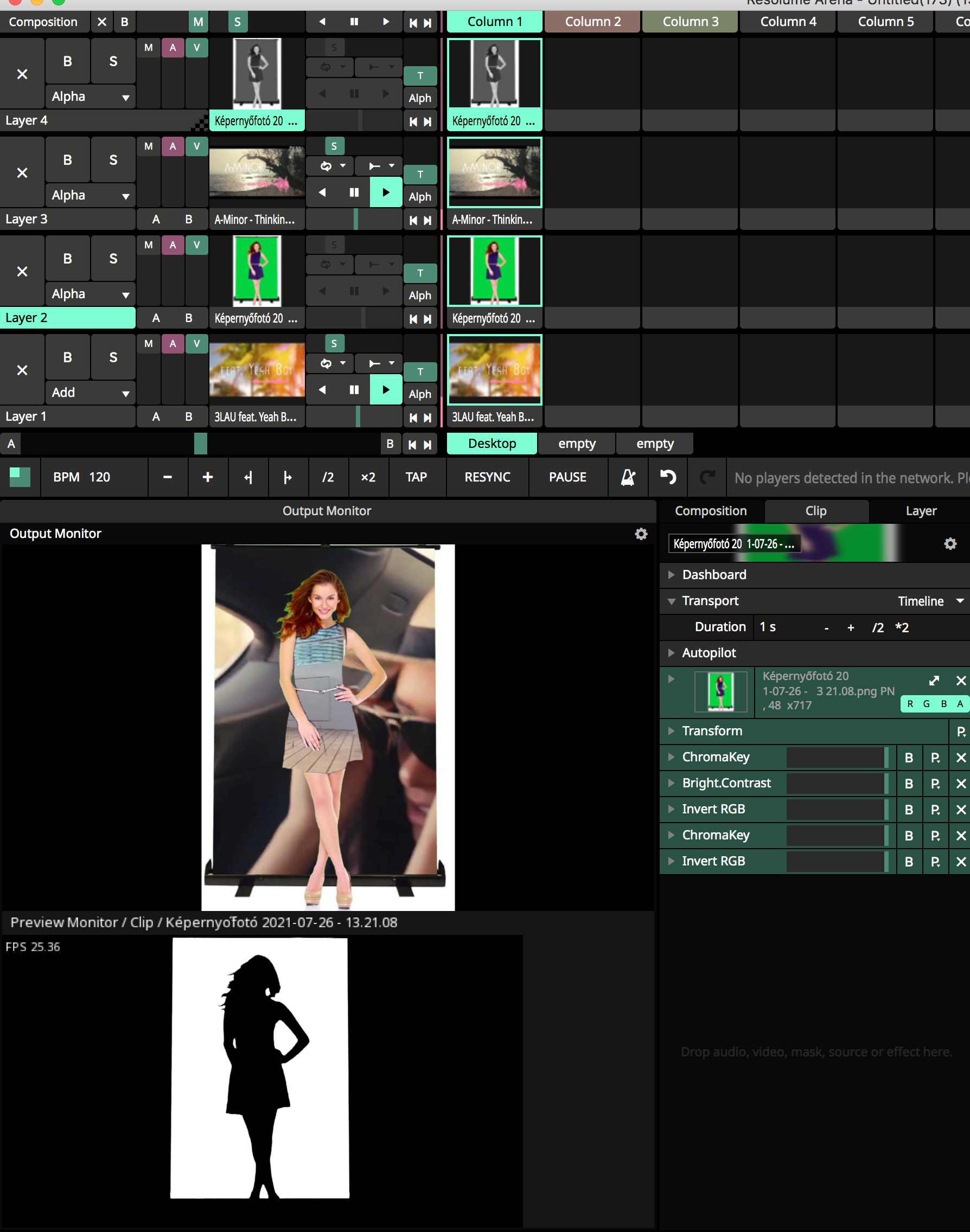

Could you upload a sample of your image you'd like to filter?
Also, you'd like to place a video over the dress, and another over the background?
Like this?
vjastral
Posts: 6
Joined: Sun Jul 25, 2021 16:40
Re: 2 chroma key simultaneously
Post by vjastral »
Thanks for finding time to replying to this post, Zoltán. It seems that your picture fits my issue :roll:
Posts: 7654
Cool, so what I did is just a regular chroma key on the layer 2 clip,
and then another one on layer 4, to get the background out,
brightness contrast to make the image black,
Invert RGB to make it transparent + white,
another Chroma key to remove Alpha.
Then invert RGB again to flip black with white.
And use layer 4 to mask one below.

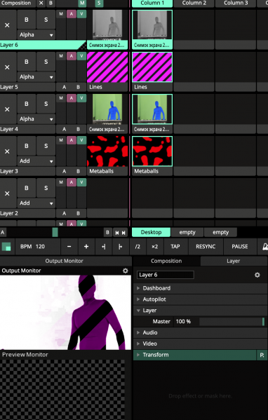

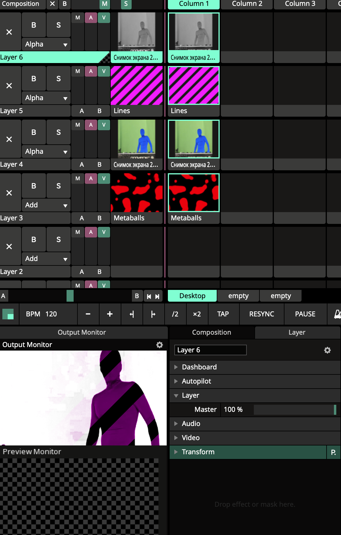

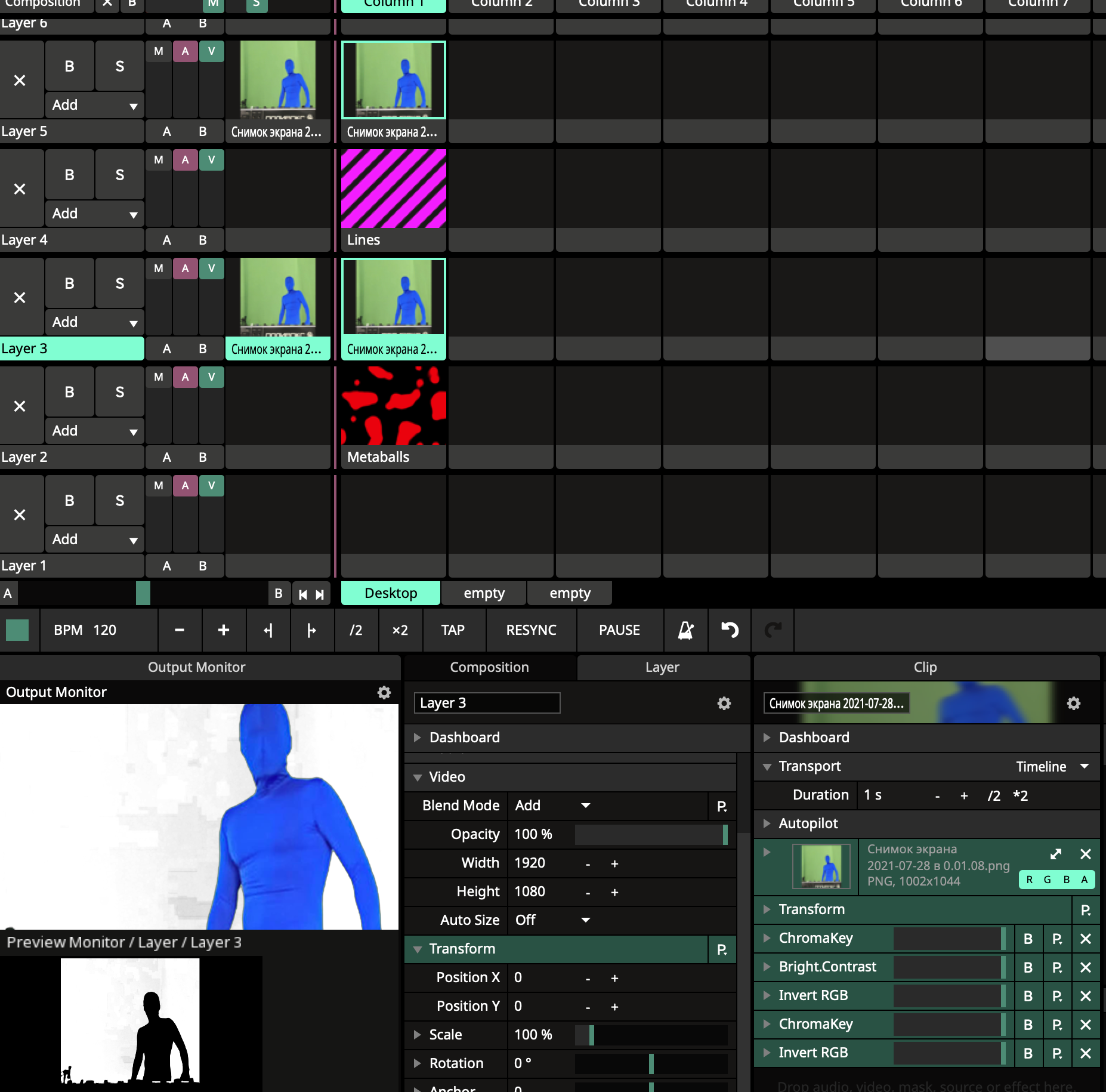

Thanks, very much, but somehow it didn't work on my side. I have attached photos. What is the point I am missing :shock: :?: Much thanks in advance 🙏
Posts: 7654
The effect stack should be on the clip in the masking layer.
The masking layer should be the top layer.

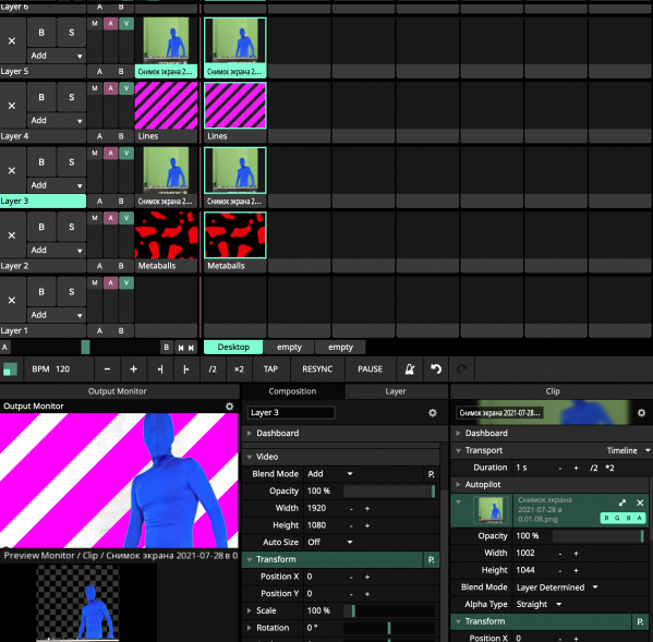

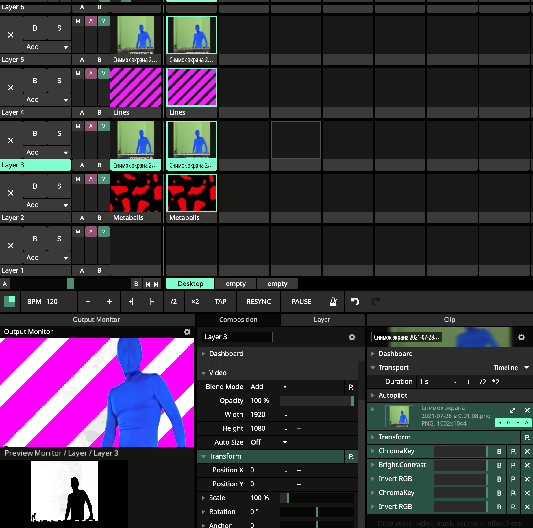

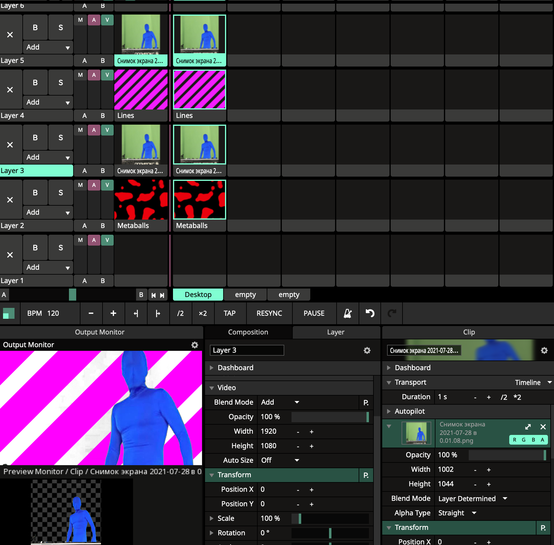

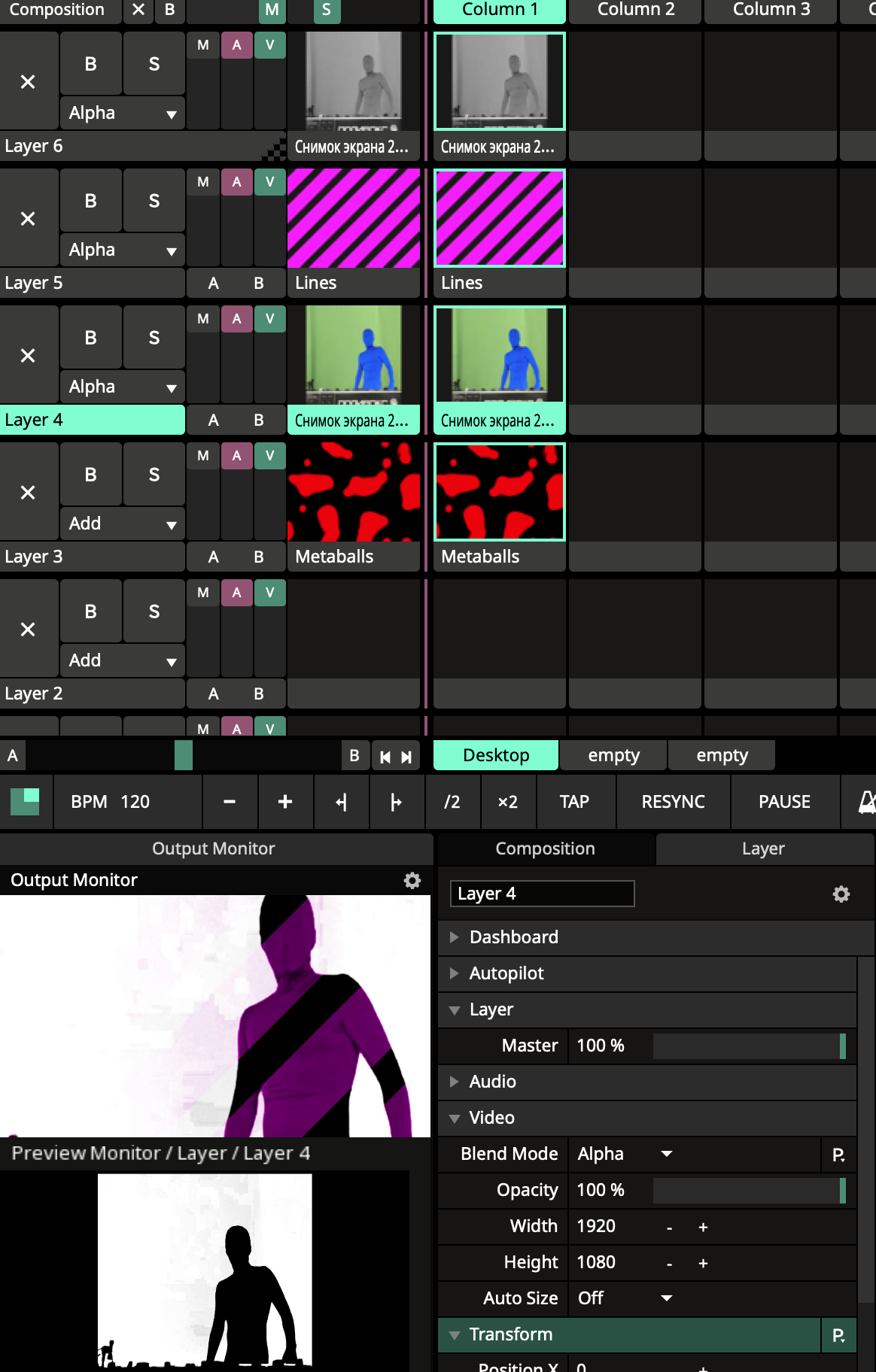

Ok, thanks, I found that mask function Layer -> Mask mode and made the first clip masked as on your screenshot, but I guess that somehow I don't have composition+clip+layer stack as on your screenshot and I don't know why :? Also, there is a white background as you can see... :(

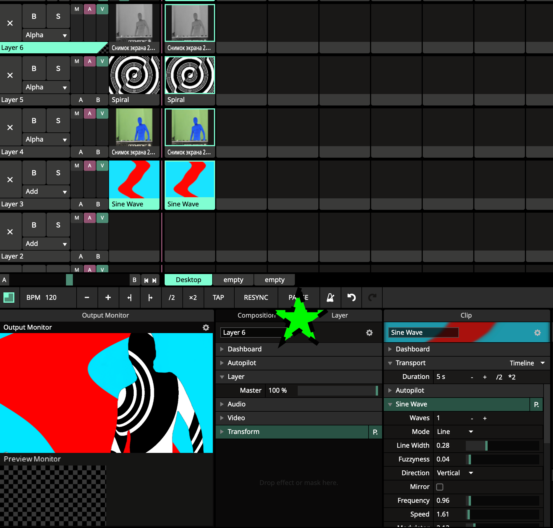

Finally, I achieved the result I needed thank you very much for this! :roll: My last question is about your screenshot, you do have composition+clip+layer... I made a green star on me to mention.. how did you make this and what are the advantages. Wish you all the best! :geek:
Posts: 7654
Nice!
You can rearrange these panels by dragging on their name.
Then if you like a layout, you can save it in the View menu - Layout.
You can also disable and enable panels in View.
BTW, if you're using a green screen already, and want to mask the person completely, I don't think the person needs to dress up in blue necessarily. You should be able to separate the person with a combination of some effects, like the levels, invertRGB, and then colorize it, to then chroma key.
