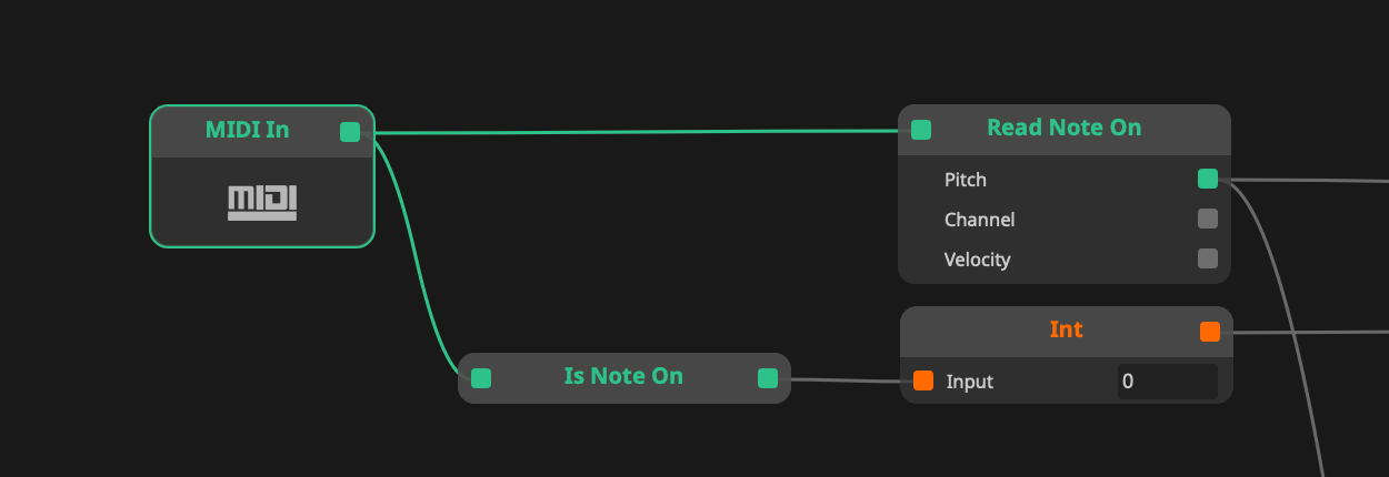

Hi everyone. I just made a Wire patch that paints vertical lines when you press any key on a MIDI keyboard. The color and position of those lines depend on the note you're pressing.
So far so good, but it's "monophonic", meaning pressing two keys doesn't work, only the latest keypress is used. I'm using MIDI In > Read Note On to get the keypress, but no matter how many keys I press, I only get one number out of it.
Does Wire support MIDI poliphonic keypress?

Re: Wire - Poliphonic MIDI in?
All midi events arrive into Wire, I guess you're feeding them into a Signal node, which only gets processed once per render.
You might be able to add a buffer in line with the events, to store them, like a Stack for example.
If you share more of your patch we might be able to help better.

Wow, Stack may be what I was looking for!
I could use a stack to capture all the notes, and the Note Off event to empty the stack.
If stack doesn't do the trick, I'm pretty sure some other Collection component will do.

This is the patch I currently have. It has two problems:
  • No polyphonic input. Only one bar at a time appears.
  • No sustain. Colored bars appear briefly both on note on and note off. I'd prefer sustain while the key is pressed, release on note off.

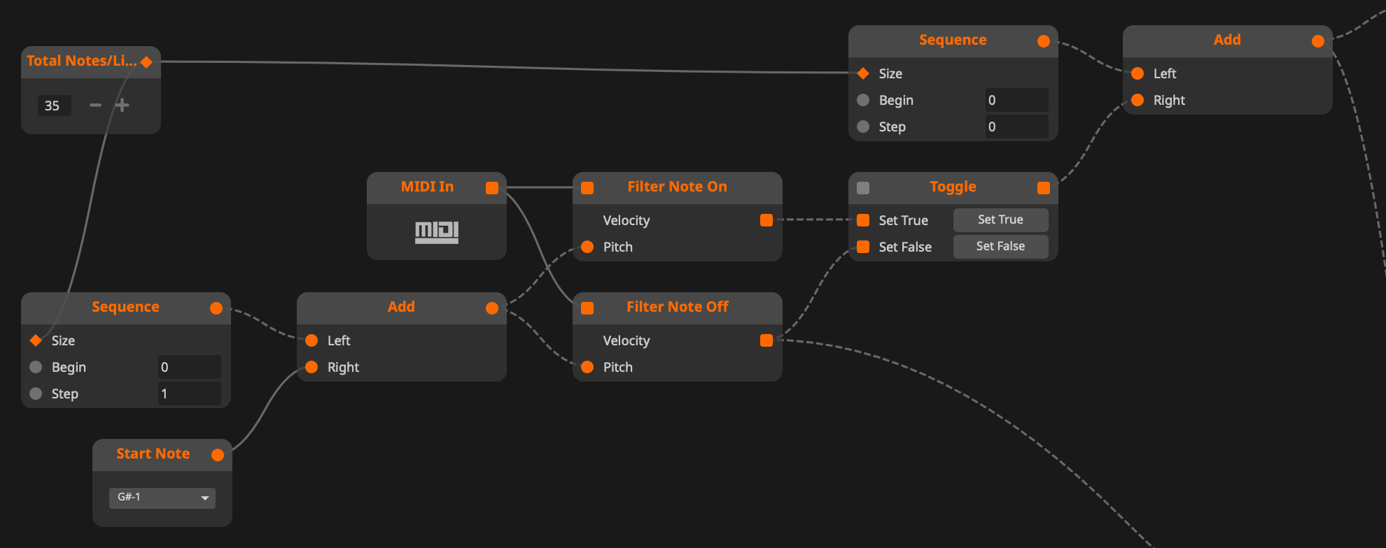

tijnisfijn
Posts: 354
Post by tijnisfijn »
Guys have a look at this patch viewtopic.php?p=100274#p100274 I think that will help you both out.
And here is just the polyphonic MIDI part:
--begin-wire-patch--
4133.3oc6ct0baaiEG+qhF1WE8RbGLuY4KY5L619v1Y2GRyrCkDsM2JS5JQkzzN469BRIKbnNxR+yklV2M8hirB3Aj.G7C.mKf+Vxrl55xYsUM0qRdwq9sjaV1be3CYiSZV29v51jWONosI7MhwIU08ew6GejhIOTwTiSdnnssbY8txY1VtrAETyj2ikSLnblGKWFshenpc1cmpbhCUtvW9lxEMypZe2tBZGmrpr8GVttbPQkOYQutXwpgk0wet8G741xdt8G74NmUtPS6ppes7DkxcfRwqSgn64XwF0gS19HDG7QQdrhJNUyiPcPg1If8uYUDY95se96WNubYxK9sjaW1r9gfF8u89wIKaZZ2nbW2LuL4E5NAu4iYwOl+9PElbeYaQ20Wrt8tlfjRRFmLqns71lkuK4E0qWrXbx7xGVz7t6Kqa+ghk2V11U9oKKpC5T8kut39f7R92UKKS5ZLVtpq4LTn6K9ucxL7XeeUc2mjx9VftKL68uuSxqlsr5g9l+dQMuZ0CKJd22sQhgunZdnZqtop6oLI2JrFkdVpYtXdp1HLoS0JapVMe1zBmVpDyBWyhpYk0qJutZwVgr8KhR89hpEa9TyxpaqpKV7Y7IS08j8yqKVzoQ7BkzaBZdKKW0rXc61K+txpauKTahLefn71p4sgqSjKCcOIqJdS4m66l16Ve+z5cOzqWt8Cuord9ld8PgpK+k1uKnZ7syC2Kga4N0jNMpjrdEj11kUSW2t4qtYQya69y128P2sT+uFDWwh0c+ZYPtschrpdUa39ey0rsrU0AsqP24thK5tCm1rtd9JZaiWFaYTgVoeInHqEmIB+i1jIxMJgLf6BMwBm8LqUnyyyjJsxYBxa1hhU8hqJ7zj3b1bmzZRMRmIUOYRVZtK7iKmb0UWeo2jG9MZSpnWBMy9ov09lfJXS2nhlE8MU2D9GaQVV+W0+70toh5mEH9bde07p3CY2Hotmy6plGznCCNIsMi2z985c8v+iu8xucz2VmP539OuoZU0zNE51.fNHHAuSAp0V005DTRtOneF.jwRNsoYQrXaqkesbYSZ0pzlat4IK5q5J63mM+30mVcK2zqtYUeppam6yNOPmTWldtJOO8R8E5KLSzpKyt7SUca1cEgExr3Xc0gUq7Y3ee86GeBc6W0OMwylez8.sYEQGqsylM9Kx+85gTg3HywCHDO1cObHYDYDlrKrthQeWSa4nu+DjiCvyCU4s0cyver1jtYmtoZwhmjDbS2BB6JTSca5pg3k.hqnk.8y6lVJLiCoHqB2Q02RlG4uW8SkiZuqZ03QuqY8nYE0iBK6L7MkiJtOLBtcTyMipCOxqF01LZQ0p1x5tOUTOuuP2TsbUaeA5902M5sga9QEKdaw6VMZZ4ntVxQqqWTtZUu7eXY2mBk79ve6rl6KG0TG9+kgJsdSsFtw1rPuCyPLh.vPlqx0aoEjY1OS5rxvRVDNg2sgujFVMyY4BqHyIbNWOKomvD9KBDltU6Xyykck+oQLpKDWlpst.hwIkoYWegwFVjjW4z3Hl4YyB2X6gXFnW12UMlnmP6k2pVD0FeY2pQOtRn322EUzOM2t01mtoX6Jd+eDEcuVbm93QK0FM3mZ1iybYNoWkIyhSVr27IBoxclSpkZkvpyramOQokmoxBWlWIxLZ6Q6ts9v7H5yyuH0KOeRZtN2IrYJkVmQ6tkerKfI6oGxF1TzG2THhwhCLch3H0zmsIth6t6IW8ROz5OKKPYyMywuk1aFi8TxG+nZ61gOwQKjgmgM3c7QmpOzQmqBbghEIO14lkNuJfIVswLKmXX5F0gOjqXu4VXERtcvb1IGMuobhO5Q8Fq2GF45x8do+fC50dyYgQmFivYb9GWDoz6OKSYCTeqeKL3HKiL+7qS0WLQmNQjccpJ25mnrSlXUed10R1WhgheoFzOXvwVszsyRsQk3PpnOpFbHkw33lymO+3CazOWVY0+53KjQJUmk6xLGXxLSVXpNgUkE10rx83DaYGZhMYX+Sv53OWWGi44RW92W+i+suOrmgC2iKr465hklGQWlCgtT1Pupx61sX1+x0oJ+psU9Cx1JcSKZ0gt6cjjiLq3UWmkpcSjogcbccZf+3tVX7V6jq+pwU9pwU98x3Jg+liwNNvJmmVda0o1B5tkihtL6sNRBUrmZEyaVVca4Coe7aBVjY4K+UXNyqz4Ytvfbm5wEI2MTOKLORVlVFF3ZyxOpcT0SyKRKb2XSykxxvPbu4F6rO0M712u7zyplssE4Hy6NT8hzOSaK2quhYs++Y4OutLnIdT0J8G+FxtqXU58E+xolNpuXU0mpXftzoyGa+xQKhz89d+UcpEI0z6dvrzEESGPjYKv4hTQBo7a+ZDgK.D92Pkt3zRWDKLv894CEOvcufb6mATCW4RFbA.U.sF.ZhtdPMfzDkQajj.0v2LnJjHUgjbApSWEubPMnPpAE4Bz.0vvGBMRUnIWfAPaZPMXPpAC4BrH5qCpBKRUXIWf6zUwjA0fCoFbjKvCLl1mL3B.pAO4BxQnFCphbjpHOdA.C5lLfafLniLlCgLcI8I.BLQISHOBWNnQB6Yf9P..NtZPMfvMDDtg.fab8fZ.gaHHbCgFA9MnJP3FBB2P.vMd4fZ.gaHHbCgEA9MnJP3FBB2P.vMNePMfvMDDtgvi.+FTEHfCAAbH..GSFTCHbCAga.Lh3hrDZ4Os7IiGjHKFKOYvE.TADrgDZEYCpBDrgjfMj.MRWNnFfZknMSJD12fp.gaHIbCI.23pA0.B1PRvFR.rw0CpADrgjfMjVD12fp.AaHIXCEh1Dc.AR+.oa.nW3Rp3Q5DH8AFD8Hp7Q5BH8..c.WQEORyOo0GfYeMU7HHaBw1in9PkOBulfqAn0ujJdDXcjUiPgnKwC.BEQPHf5WRaaP.0DNMBl9bp3AfzDFMBh97A29HsNjlG.tvDp3AvBD5LBb9BZWK.VfflQHyW7MT4CfEHfYDt7kTwCfEHPYoCgpQkO.WPF4BR.tvUTwCfEjQrfD.KbMU7.XAYDK.szAJW.P0LpYpxPXlToCvETQtfBfK7Rp3A3BpHWPIQvZT4CvETQtfBn0+bp3QZ7Is9ZDrFU9.fAUDLn..CSnhGfKnhbAE.W3BYBs7mV7Qtfxgf0nxGfKnhbAE.W3Rp3A3BpHWPkiLxkJe.vfJBFPVvOkK.n5D0bzH1QlbuqAvB5HVPiXDYp3AvB5HVPCYAYp7AvB5HVPiX9Xp3AvB5HVPCY6Xp7Q5aIctHFNlJd.rfNhEzPVMlJe.tfNxEzHlLlJd.rfNhEzH1KVkPK+oEeDKngLVLU9.XAcDKfrKcJV.nuM10ZPLSL4d2.fELQrfAxFwT4CvELQtfAw.wTwCfELQrfAw5vTwCfELQrfAxzvT4CfELQrfAwtvTwin5PzcfLJLU9.XASDKXPrHLU7.XASDKXfLGLU9.bASjKXPrELU7.XASDK.YZMJW.nwO11aQrCrNgV9SK8HWvBYDXp7A3B1HWvhX6Ep3A3B1HWvBsGNp7A.C1HXvhrTPp3A3B1HWvhLkBU7.bAajKXgTMoxGQ0jnaBvEdIU7.bAajKX8HXMp7A3B1HWvBvENmJd.tfMxEPZbnXAfFmXaiCJdWH27N.tfKxEbHtEmJd.rfKhEbHdOyjPK+oEeDK3fbFAU9.XAWDK3PbFAU7.XAWDK3fbFAU9.bAWjK3PbFAU7.XAWDK3PbFAU7HZ9DUeHmQPkO.VvEwBNDmQPEO.VvEwBPPMJW.3tOdy6g7FA4t2CvE7QtfGwaDTwCvE7QtfGxaDT4C.F7QvfGwaDTwCvE7QtfGwaD1DZ4Os3ibAOj2HnxGfK3ibAOh2HnhGfK3ibAOj2HnxG.L3ifAOh2HnhGYjEYnEh2HnhGfK3ibAjEiPwB.RmHbHmQPt4yAvB4QrPNhyHnhG.KjGwB4PNifJe.rPdDKji3LBp3AvB4QrPNjyHnxGfKjG4B4HNifJd.rPdDKji3LBRfjlCfExiXgbHmQPkO.VHOhExQbFAU7.Xg7HVHGxYDT4iLxMNzcU5rtSgiSGl+qqqNYxP91p4aOyqd5RgdPQI7YcYchOe2YzytSZgrLuMyjabYJwwxtLoUmmpKlNMcpxeSptTjkYDAgJLeVNnEN9ZlN9IEULYM1jAEwb7XSZWre+ytF28ylh8yVh8SHh8y2g8iZk8iJk8ce89dmdeuXsuWp12b16at58sq09lsZ+82t+9W2egt6uN18mva+IzXozAKiMXwtMK1rYQoIKLLYwsFKtzXQdFKzxXAOFK3vXg+EK9tXQvEKDsXAgEKHqXgQEKNoXAqDKXjXgaDKdhXQLDKhfXw7CKndXgsCKtbXQdCKxZXwNCK3XXg+BK7VXAvBKBUXwfBKHSXA5AKPNXgpAKVLXQaAKZJXwKAKfHXg7.KjFXAs.KpDXwc.KvBXgN.Kz.XN+m4cel+6Y9mm4jblWvY94l4HalqpYthl4rYl2jY9Kl4OXlGeYtzk4zVlSYYtck4WUlmSYtFk47SlyMYdXj4BQlSBYNAj4lOle7Xdpi4JNly1XNSi4tLl+vXd7h4QKlOqXNkh41IlakXNNh4YHl2YXteg4fElCTXtHg4CDlWNXdwf4mBliHXtZf4KAl2BXdCfYuelA8YlrmYRdlQ2YVUmYZaloqYFmlY8Yl8kYFPlYhXlIfYF4kYEWlcZY1gkYoUloTYFKkYMTl8NY1yjYwRlIIYlEjY1Olg8XVtiYaNls2XVWiY9LlAxXV.iYiKlMrXVohYFJlglXFRhYpHlsfXV6gYNGlMUX1LgYUDlYOXF1fY3BloIX1dfYcAl0CX1GfY..1V7Y6gmsKc1tvY6ylsQZ1VkYaElmk07znlmmz7Dglmoy7LYlmpx7bQlmrw7jIlmsv7zAlmuu774kmvt7Lxkmxs7bpkmzr7jhkmUp7zNkmWo77FkmXn7L+jmZm7b2jmbl7jujmck7zmjmej77ejmfi7LXjmhh7TPjmig7jHjmFe77zimHd7DsimIc7TkimKb7bcimLa7rUimNZ77MimPY7DFaqknHm8FsEKa6OXWN5oug4OsGGhh+LcZHxN8WTN6SdJOAdBZ++CG8gY+QdnEZ+3OryPUC7d6m3AotddoMUWp6N29ymlNUZEtB6zhRcwmaqwFZHtc3oU0yuSfqcubV9K2iU+qml+J8T8DV5ON98GZt81EGe5I2WOyw.vM5ryTpLkO7ir9Syxmcm2XYe4Nuw7e8.f9iaIOOw48btB9PS8qm1yOONsmy+PGhrqrHmJeOd7+Ber7cBeJucfF5g22wOW9DeHg.P1e.A.PpPc3WsFV0YxvvLs2qCiGk+gED.e7N3+Ics+das8GZZKVzu01U+3e6HJxc8NU8G5sgqaY+KCttFPYt8r.Cyn0B+t2mI8uaRLYmElYUZrJsyZ5Oru+0lt2ZcYcmF9Fu06M4x7PSee.ySdEL7pt28LcCb5VxR2NO5dMVMNo66TI8Ge5ca0t67Wt+f0t+8PP+qJjt4i5NCLCi2+erUiyYA
--end-wire-patch--
JonasVorwerk
Posts: 30
Joined: Mon Oct 23, 2017 20:13
Post by JonasVorwerk »
Using the toggle node in combination with the filter node solves this issue, thanks Tijn.
Here is my patch, with moving lines instead of using the alpha
