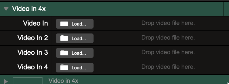

Wire can load files directly now,

That's great to know and makes this patch way easier to put together. I think I had misinterpreted the use of the Video In node.
Just so I know I have it right, I would connect the output of Video In to the input of my Video player nodes which I could then drop clips into?

Yes, that's about how you'd connect them up,

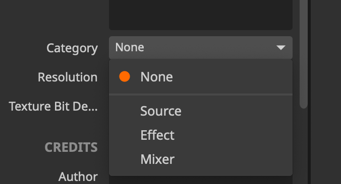

Your patch will work fully functional, with the watermark, so you can build the patch and test it out before buying.
When saving the patch, make sure to select a Category for it in the Wire Patch panel, after that it should show up in Resolume

Ahhh choosing a category was what I was missing, thank you!
