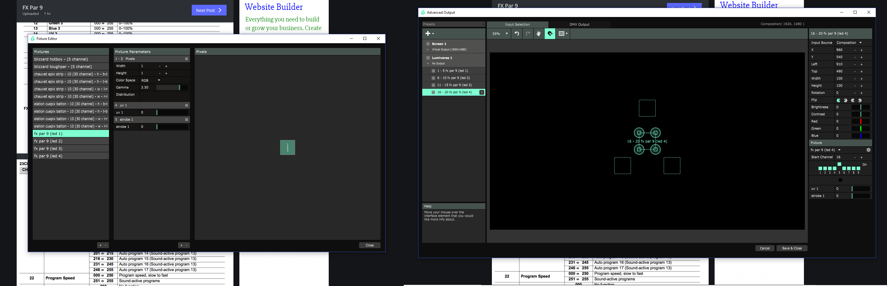

So I've got a couple of fixtures which have what I'm guessing is an unconventional DMX channel layout.
Here's a link to it: https://imgur.com/a/Gkl4KT8
I've tried to recreate these fixtures in the Fixture Editor of Arena 6 and I can't figure out how to do it.
There are parameters in this configuration that are interspersed with the RGB elements and if I was able to add more than one pixel block it'd be pretty straightforward to do this.
