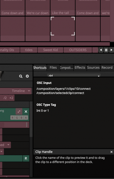

Where is Custom OSC found? It doesnt seem to be in the shortcuts window, I've turned off all messages, but when I click on a field, its just has the default path in it and no way to edit it. It looks like a different UI to me...
Posts: 7741
Re: Choosing osc to send instead of all or none
If you create a new OSC preset, that will be your "custom" one.
Clip triggers are easy to map, you can click on a clip thumbnail, and then select all clips in composition. That's one shortcut for all clip triggers.
