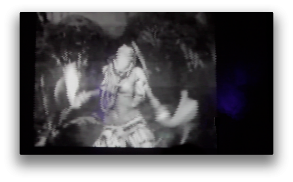

I got a problem last friday with the projection. During sound/light/video check in the afternoon everything was fine until in the first part of the show the projection on the screen got weird. Kinda like "interlacing on crack or acid" weird. I've put a picture in attachment for you guys to see it clearly (allthough I think my formulation is quite accurate
This problem continued for a while but then went away again. In the pause I rebooted/disconnected/reconnected my system, but it got back. Then went away again only to come back once in a while for a couple of minutes.

So does anyone knows what the problem was?
Is it looking for trouble to send full hd over 20 meters of VGA cable?
Was it a cable problem?
One collegue thought it was a sync problem.
Another collegue thought it was a ground loop building up.
Nobody really knew what was happening...
Hope someone can identify...
