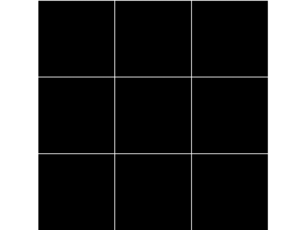

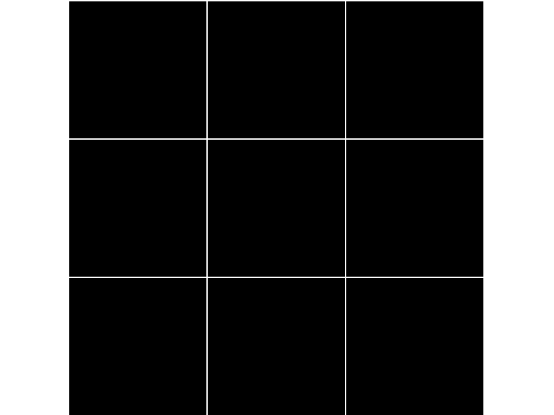

Basically my set up is a big square screen divided into 9 small squares. - pict1
Pict1
Pict1

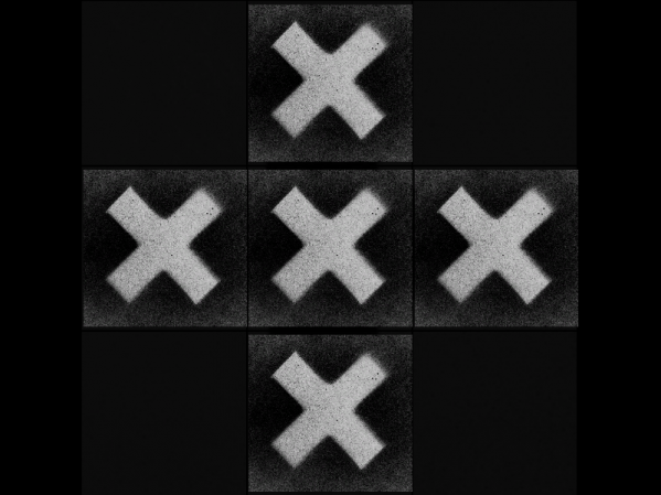

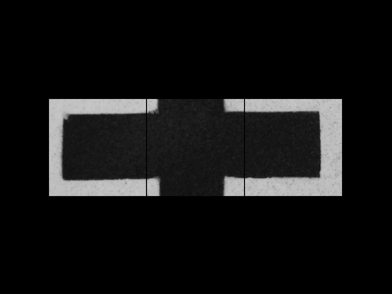

Layer 1 and 2 - to cover the whole screen, like a full screen - lets called it 'main screen'- pict2
Pict2
Pict2
Layer 3 - on the screens on the corner - pict3

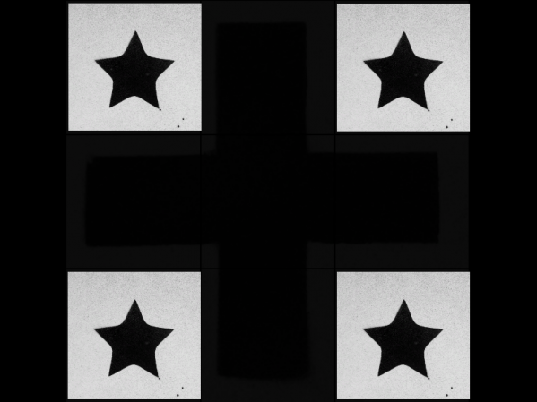

Layer 4 - middel screens - pict4

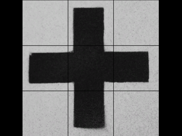

The problem is that I would like to use different blend modes when mixing layers to create interesting effects with the layers bellow, more important it means I could use layer 2 on 50Mask blend mode and black&White PNGs to mask layer 1 - the main screen - so I can create different patterns - pict5
Pict5
Pict5
But because I am using Layers to Slice it seems that (according to Joris) the blend mode does not work and all I can do is to fade in and out between layers.

if you want to blend only layers 1 and 2 set the whole screen sclices' input to composition.
if you want to use the corners to blend with something on the corner set up the composition
size so that you have 4x3 size instead of 3x3, you can use the first 3 colums of the 4x3 to route to the whole screen, and then the 4/1 and 4/2 rectangle spaces to route to the corners and the middle destinations
output setup will be 3x3.
all slice sources will have to be composition
or for simpler positioning you can do 6x3, and so you only have to position the layers for corners and middle horizontal.
hope it is clear what I mean :)

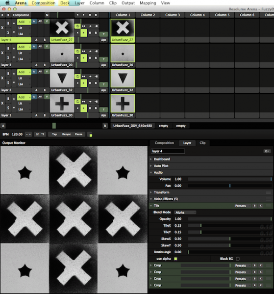

Btw, I couldn't resist trying to recreate this using effects.
The square aspect ration made things a bit difficult, but attached is a comp that recreated your setup. It uses Tile and a few Crops on layer 3 and 4.

First of all I want to say thanks you to Ravensc for the 4x3 suggestion as I managed to recreate that and it works well. The problem I was having with using Mapio is that having the effect on every layer was slowing down my MBP quite a lot. Now it runs much better.
And also thanks to Joris for coming up with this great solution as well using Tiles and Crop effects (and for sharing the project), I just love Resolume community. The advantage with this option is that I can see how the final output looks like on my output screen in Resolume since this is quite important to me as I am performing on stage.
