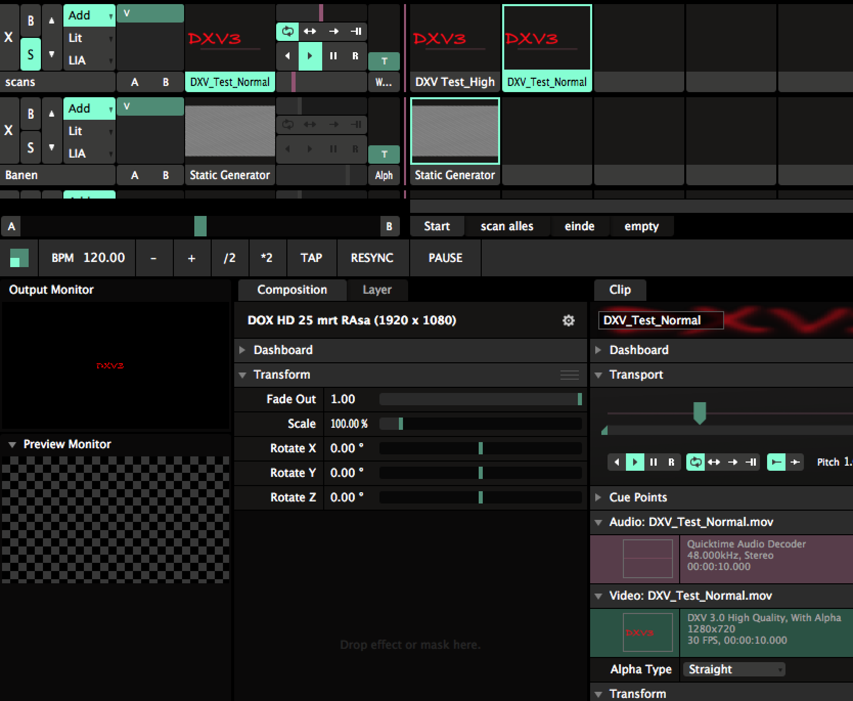

The 'high' file works perfectly. It says DXV3 and in an alpha surrounding.

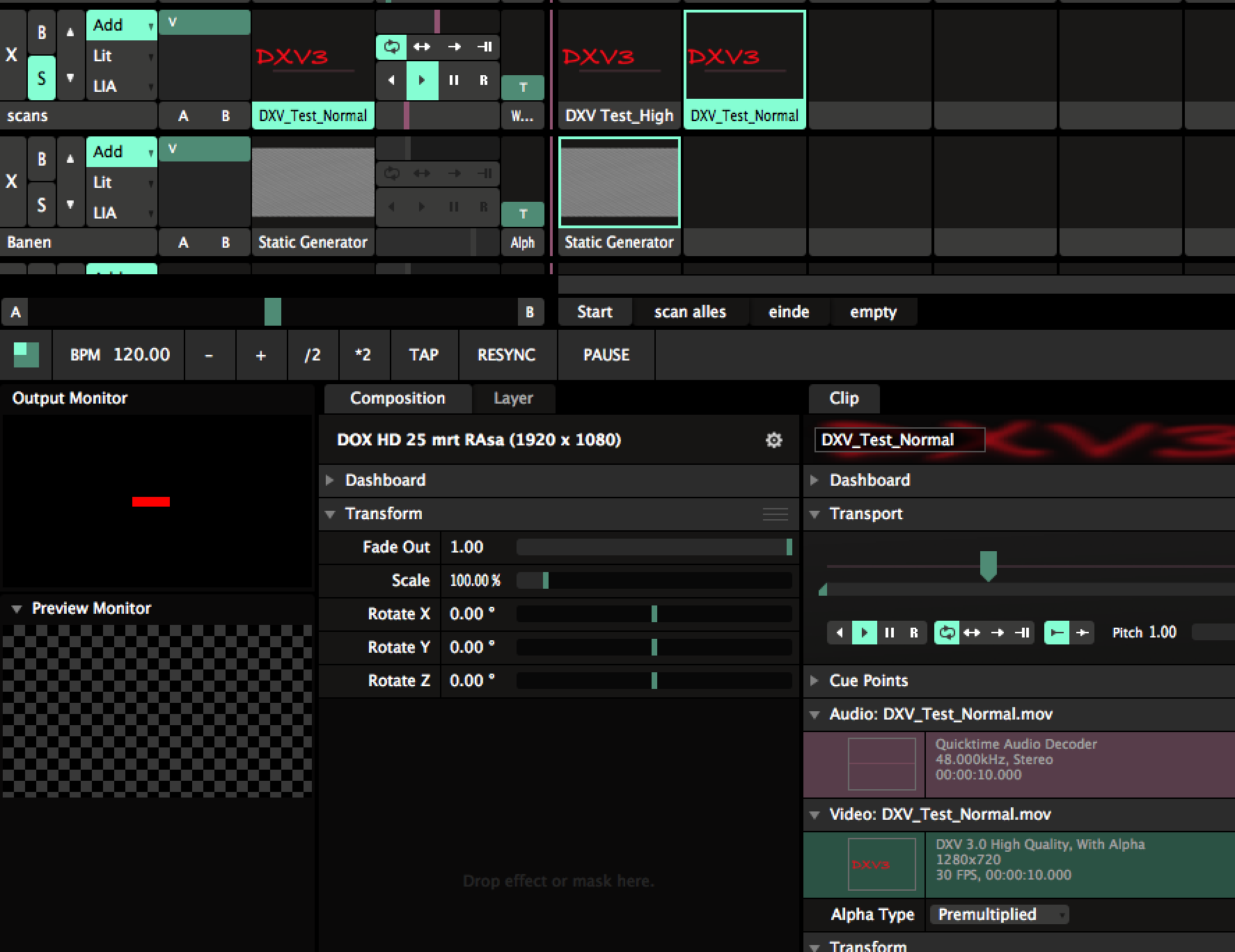

The 'normal' file has the same weirdness. In the preview it has a black background & when I trigger it the background is transparant. When I preview whilst it's triggered/playing, the black background is gone.
Also, I don't know the footage very well, but the preview is a line instead of text, is that normal?
I was looking at the clip properties & now noticed that even on your clips the alpha type in the video properties for the clip is on premultiplied! Putting it to straight there does make a difference on your clips & on some of mine (not all of them....)
Hope these screenshots are clear.
clips properties adjusted to straight
clip propperties as orginally loaded
text = line in preview
alpha layer = black in preview

This article may help you understand what straight and pre-multiplied alpha mattes are and how they get interpreted: http://dvd-hq.info/alpha_matting.php.
I think pre-multiplied is the default mode in Arena so whenever your alpha channel doesn't behave as expected, changing the mode should be the first thing one does.
The footage I shared with you was encoded as straight alpha matte so if you select pre-multiplied it gives an opaque text box because it doesn't have the right combination of RGB & A information. Whenever I create content with an alpha channel, I personally always use straight alpha matting to avoid as much as possible losing color information as the footage gets re-rendered downstream from my studio.

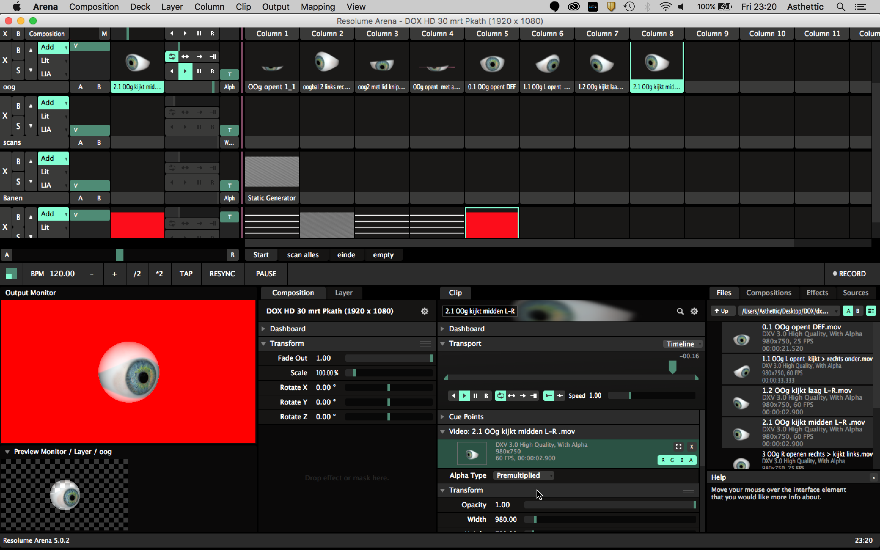

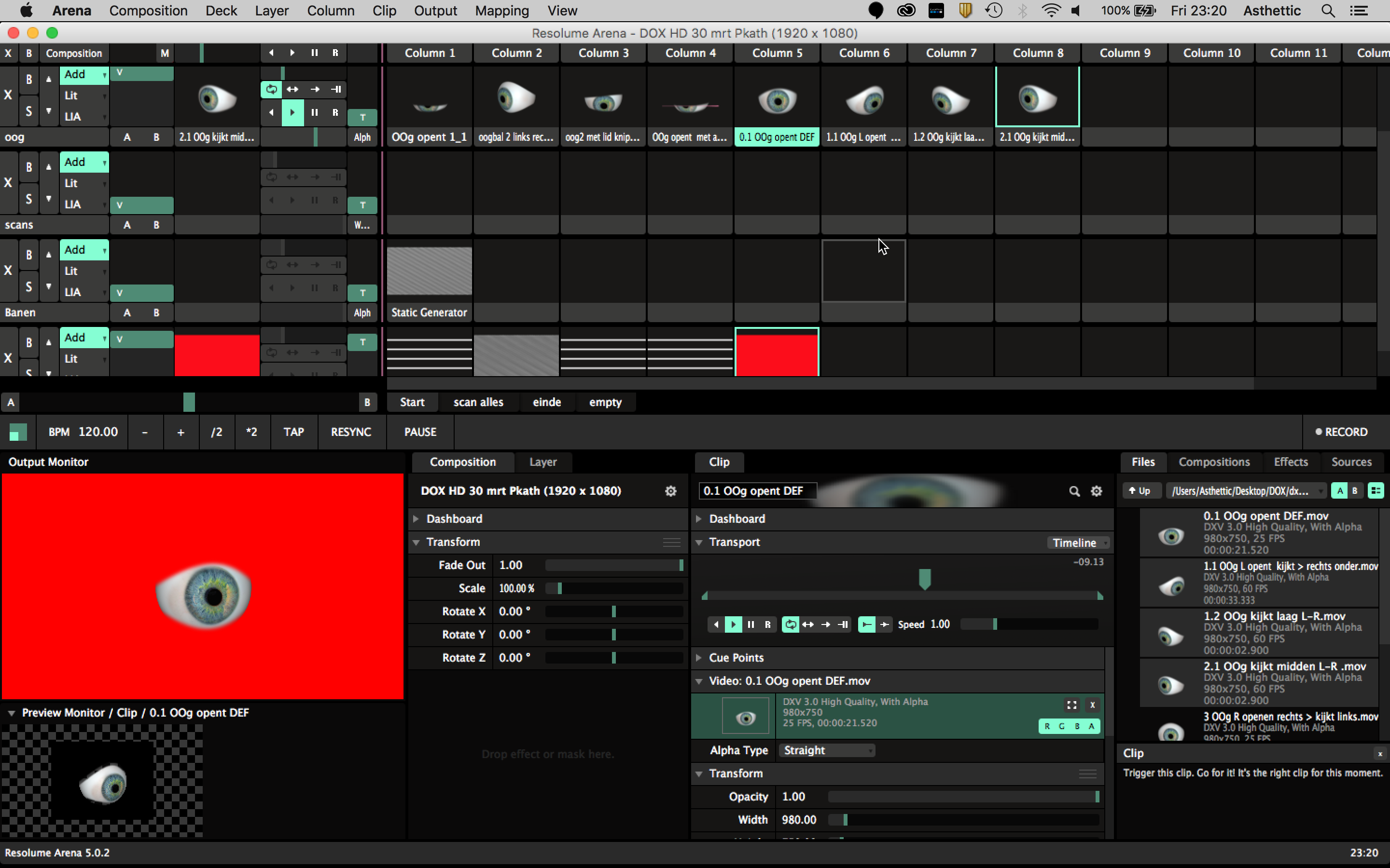

As promissed some fullscreen shots
Big thank you again, understanding alpha better helped loads; looks like all is working ok now.
I exported my clips alpha 'straight'.
then manually, per clip, adjusted the clip setting to straight. It seems to be premultiplied as default (maybe a nice option for the defaults preferences in an update? ;) )
In Preview alpha is still black , but the clip triggers fine now
export straight, clip setting straight. preview = black, trigger = fine

btw when my clip is exported straight & left on the default setting premultiplied, I still see the part that I had masked out completly in Ae. Same goes for the greenscreen & random white bits that were never there before export or outside of resolume.....
Without it being an issue, still finding that kind of hard to understand..?
export: alpha straight; default setting clip = premultiplied. Strange to see what I masked out came back
same file but default clip setting still in premultiplied (hello greenscren & white debris?)
