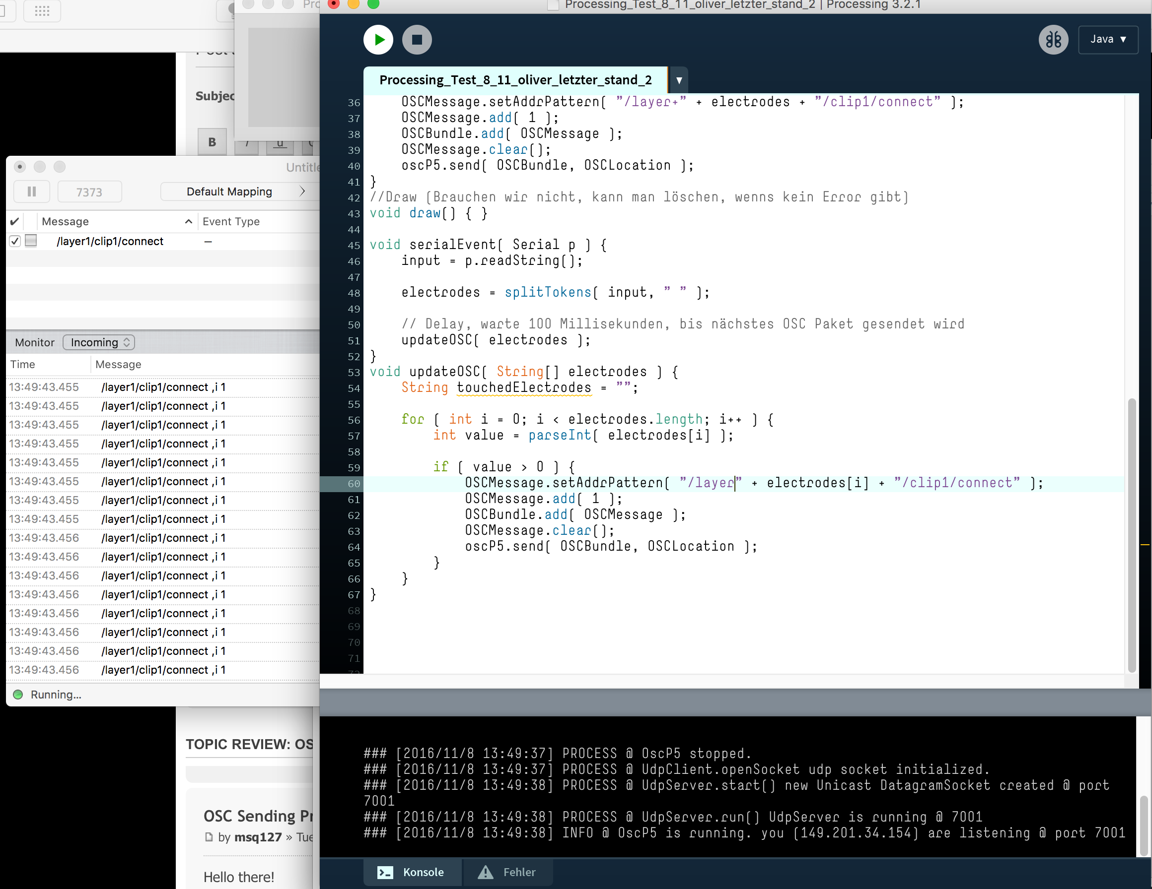

for a university Project I am trying to connect a touch board to Arena via OSC.
Aim is, that if an electrode gets touched a dedicated video gets played.
The Ardunio Code works just fine, but something in the Processing Sketch that should
send out the OSC to Arena does not really work. I can't get the OSC messages to be sent out.

void serialEvent( Serial p ) {
input = p.readString();
electrodes = splitTokens( input, " " );
updateOSC( electrodes );
void updateOSC( String[] electrodes ) {
String touchedElectrodes = "";
for ( int i = 0; i < electrodes.length; i++ ) {
int value = parseInt( electrodes[i] );
if ( value > 0 ) {
touchedElectrodes += i + " ";
if ( touchedElectrodes == "Unkown" ) {
OSCMessage.setAddrPattern( "/layer1/clip1/video/position/playmode" );
OSCMessage.add( 1 );
OSCBundle.add( OSCMessage );
OSCMessage.clear();
}I'd be glad if someone could help me solve this problem.
