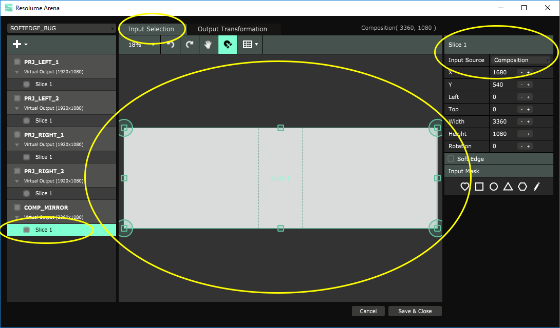

- Create your composition (for example 3360x1080 px)
- Set up a virtual output with the exact size of your composition and call it "COMP_MIRROR"
- In COMP_MIRROR create only one slice taking the whole composition area and "Composition" as input source

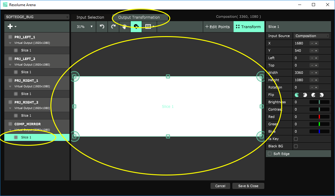

- Check that the output transformation covers the whole area

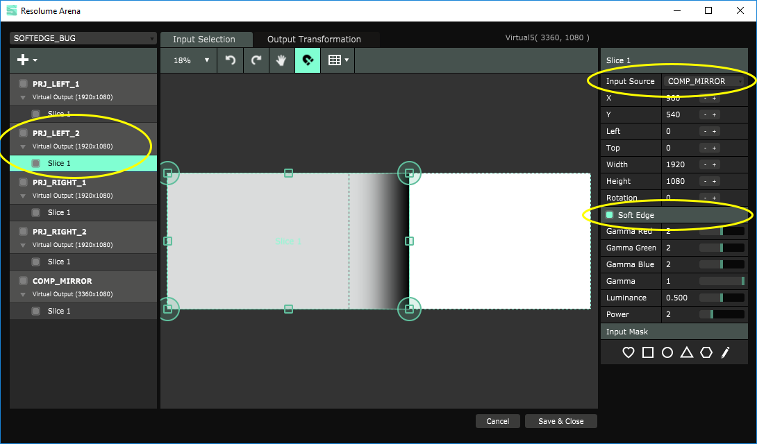

- set up the first projector of the "left stack", with only one slice and "composition" as input source. Don't forget to turn on "Soft Edge" checkbox - set up the second projector of the "left stack", with only one slice and "COMP_MIRROR" as input source. Turn on Soft Edge - Do the same with the right part of the stack

- Use "Ouput Transformation" to get the stack (and soft edge) perfectly aligned

I get the best fps performace when using the virtual device to mirror the composition. It's also more straightforward than layer router.
For future reference on this topic here it is a short explanation with screenshots:
