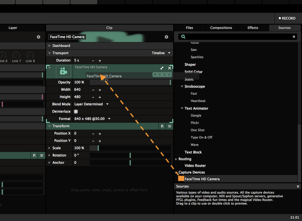

I do not have this problem with PCI-capture cards, but with USB devices (magewell or external webcams) it happens from time to time indeed.
Normally I just grab the live source and place it right there. This way it will keep all the transform-settings, effects etc. If you have made a lot of copies of the camera with different settings it might be some work to replace them all..

Create a layer just for your sources and use a video router source clip in places where you want to use the input. Locking the content on the layer also secures it in case of column triggers etc. When you start your composition you then only need to replace the source one time.
