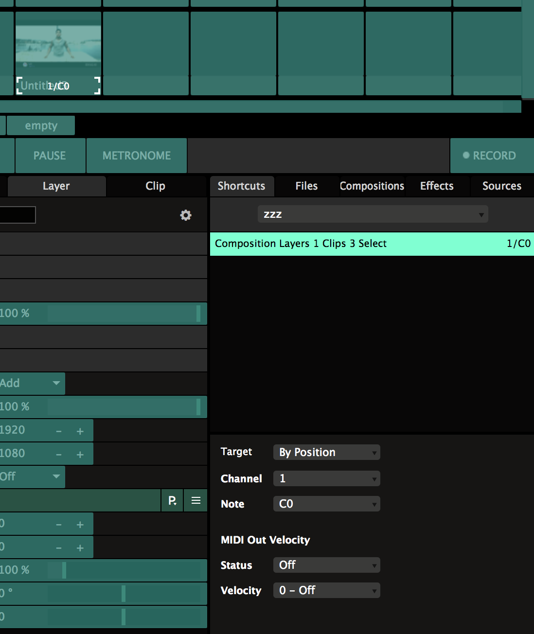

You can map the clip's name handle to have it preview.
and similarly the clip's thumbnail handle to the clip launch (output)
