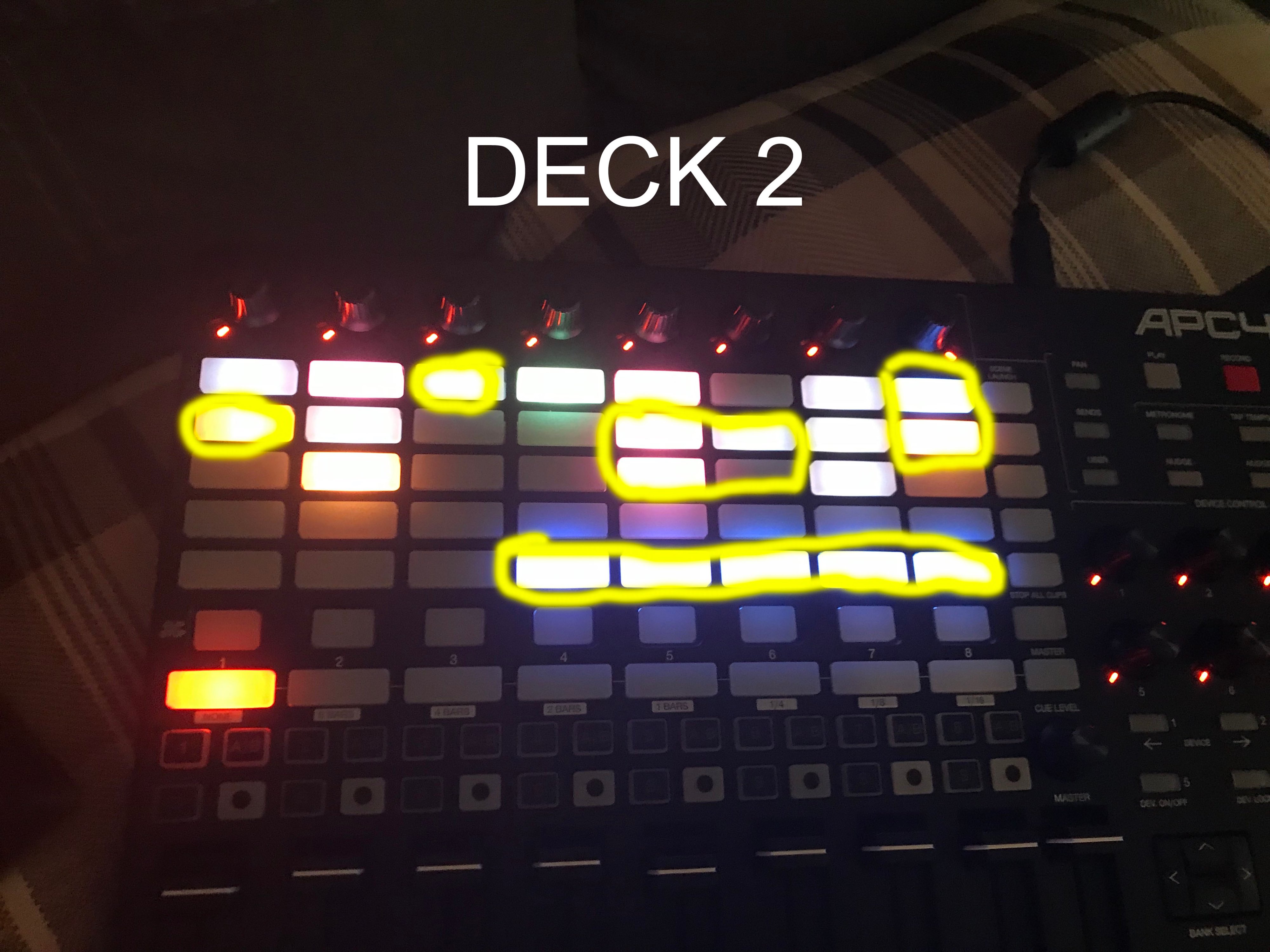

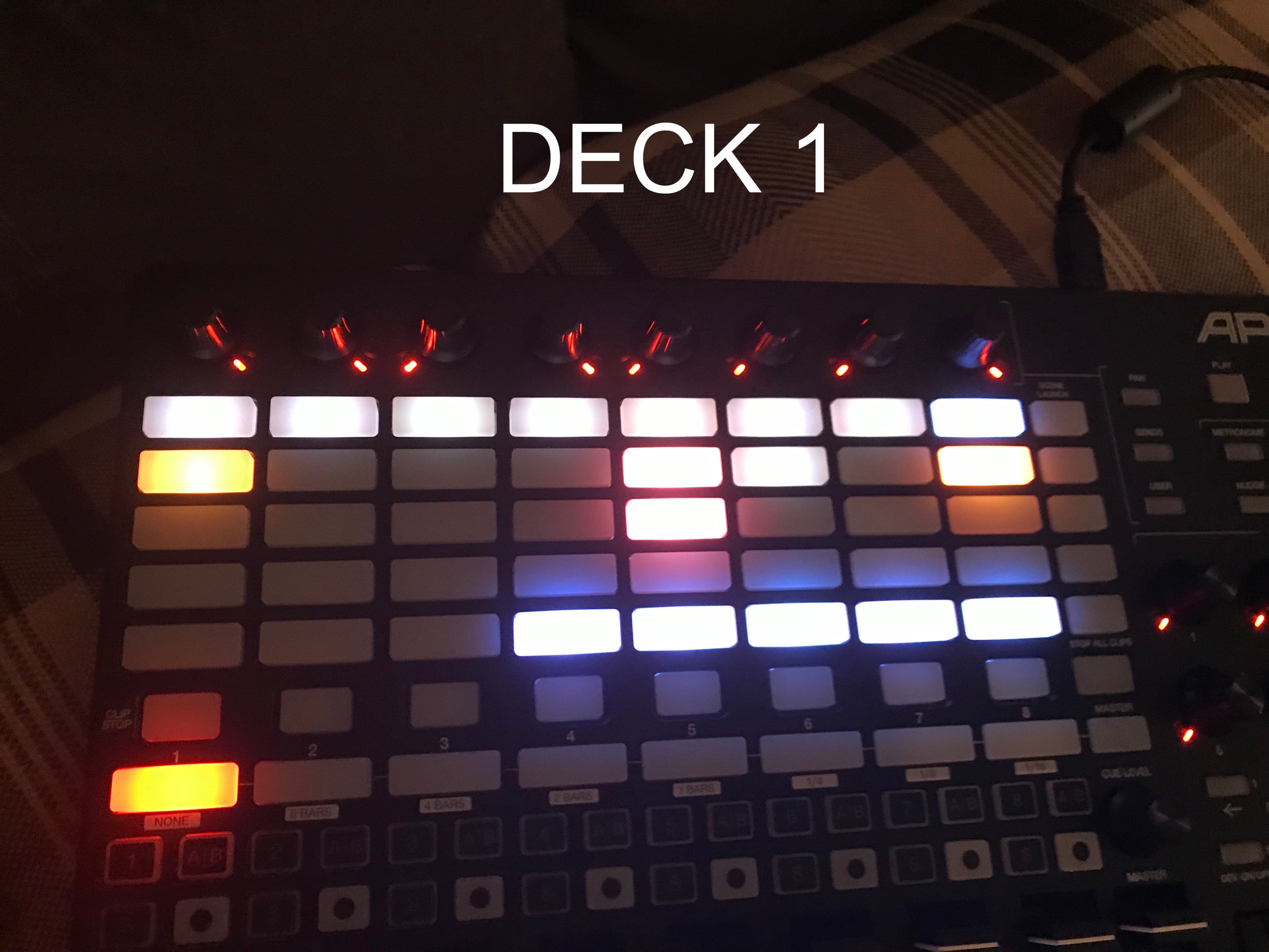

cfichter
Posts: 4
Joined: Mon Apr 29, 2019 21:54
Re: MIDI Shortcuts Between Compositions and Decks
Post by cfichter »
Zoltán wrote: Thu May 16, 2019 07:45 Could you send a screenshot of the settings of one of the shortcuts which doesn't update?
See attached.
shows one deck and the correct buttons are lit up. Then I switch to
and change the shortcuts to the ones programmed for that deck. When I created the shortcuts for each deck, I started with a completely new shortcut so there was no chance of crossover.
Everything circled in yellow on deck 2 is a light from deck 1 that stays on when I switch to deck 2 and change the MIDI shortcuts to the ones programmed for deck 2.
If I go through and push the buttons that shouldn't be lit up, they will then go off and not come back on, but in a live performance I might have 10-12 different decks I'll go through, and I won't 100% remember whether or not a button is supposed to be lit up or not.
