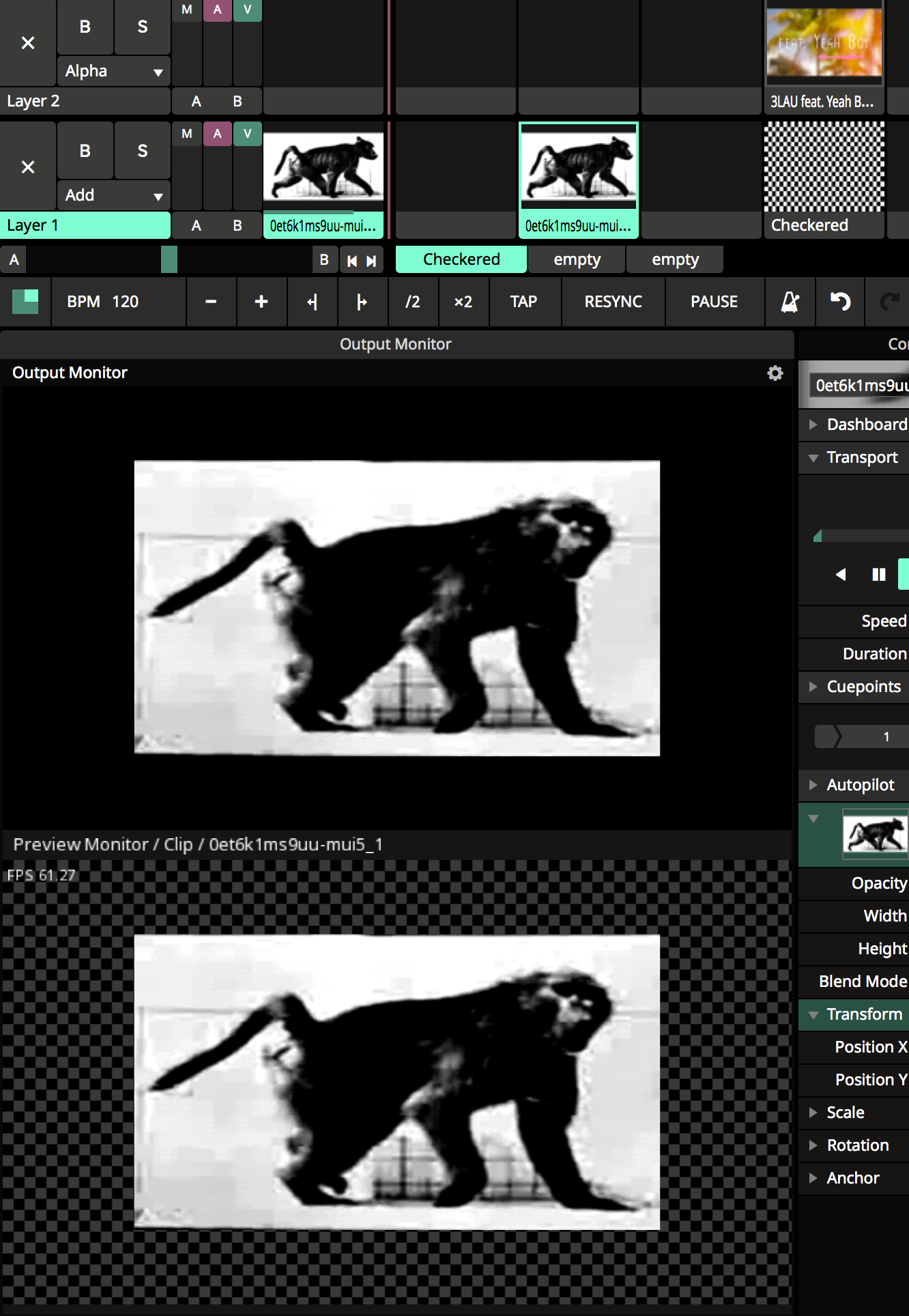

Sounds like you might be playing the clip on the bottom layer.
The bottom layer composites onto transparent, so your clip should already be on a transparent background.
Monitors and projectors can't show transparent though, only black, but if you preview your clip or composition, you should see a checkerboard background behind your clip in the preview monitor:
For playing the clip on layers above other content, the Alpha blend should be a great starting point.

The clip isn't on the bottom layer, and in your screenshots, what you've got on the output monitor is what I'm seeing in both the preview and output monitors (a black background outside the image that is obscuring all layers beneath it). The only transparency is in the confines of the small clip itself, which I've used chroma key to create. Everything outside that clip is black.
I've tried switching the blend mode to alpha but it doesn't do anything for me. I must be doing something wrong. If you have any idea what that might be, let me know. In the meantime, I'll play around and see if I can figure it out.
EDIT: Ok, it was the chroma key effect that was adding the black background! I was able to fix the problem by altering the position of this effect in the chain.
