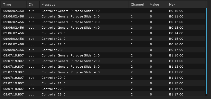

In the Resolume MIDI Preferences I can see that the signal is actually being processed when I push a button. In MidiView it looks similar (picture attached). Changing Middle C from C3 to C4 doesn't affect anything.

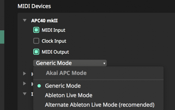

Try to set the APC device in midi preferences to Generic mode.
Though this only changes the right side knobs for me to send on the selected channels.

Thanks, this worked perfectly fine!
