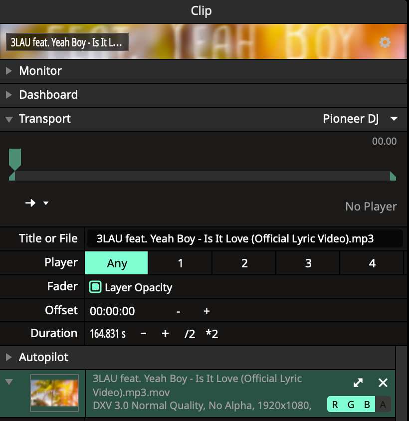

You can use one CDJ to set up the sync in Resolume.
You can also assign the video files manually to tracks, the easiest would be to rename the video files to something like "Artist - TrackTitle.wav.mov".
Then when you load the files into Resolume, you only need to set the tracks to Pioneer sync and they'd have the correct Track Titles/File set up already.
I'd put my clips into a single layer and have the composition clip target set to Free layer.
