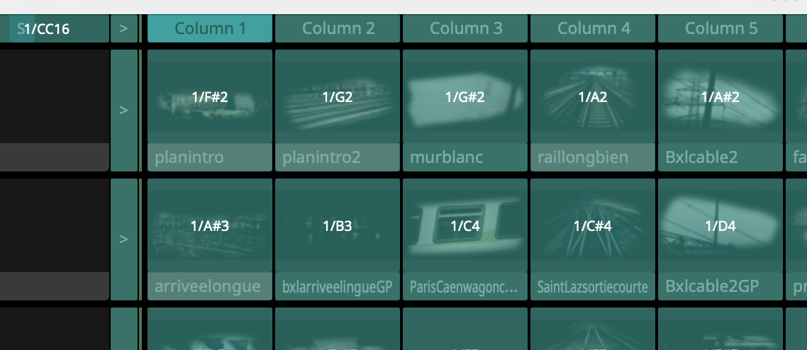

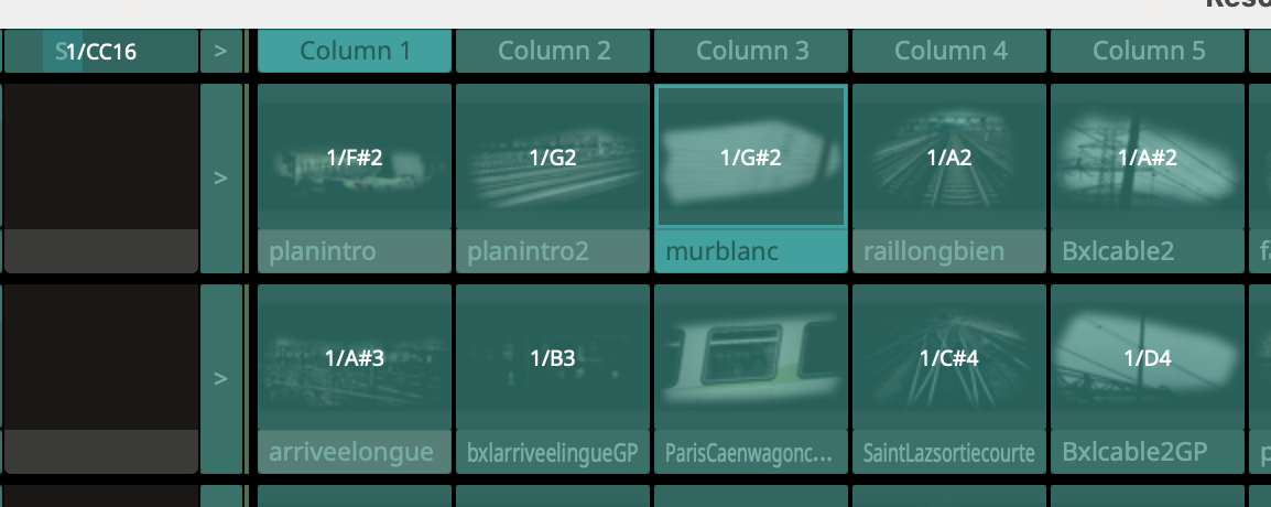

I can assign all my pattern on my Midi Akai. It works at the beginning.
But when I trigger a pattern (bouton) more than 2 or 3 times, it does not work anymore.
If someone can help me, I send two screenshots :
The first screenshot shows that I have assigned all my pattern.
The second screenshot shows that (for example) the second clip of the Column 3 has "lost" his link with the interface. I did trigger it two or three or four times and Boum, it stops working.

So, I found the solution to my problem :
I had to assign shortcuts target for all my clips to "By Position".
Most of my clips was : "Target - This Clip."
Now the bugs have disappear.
