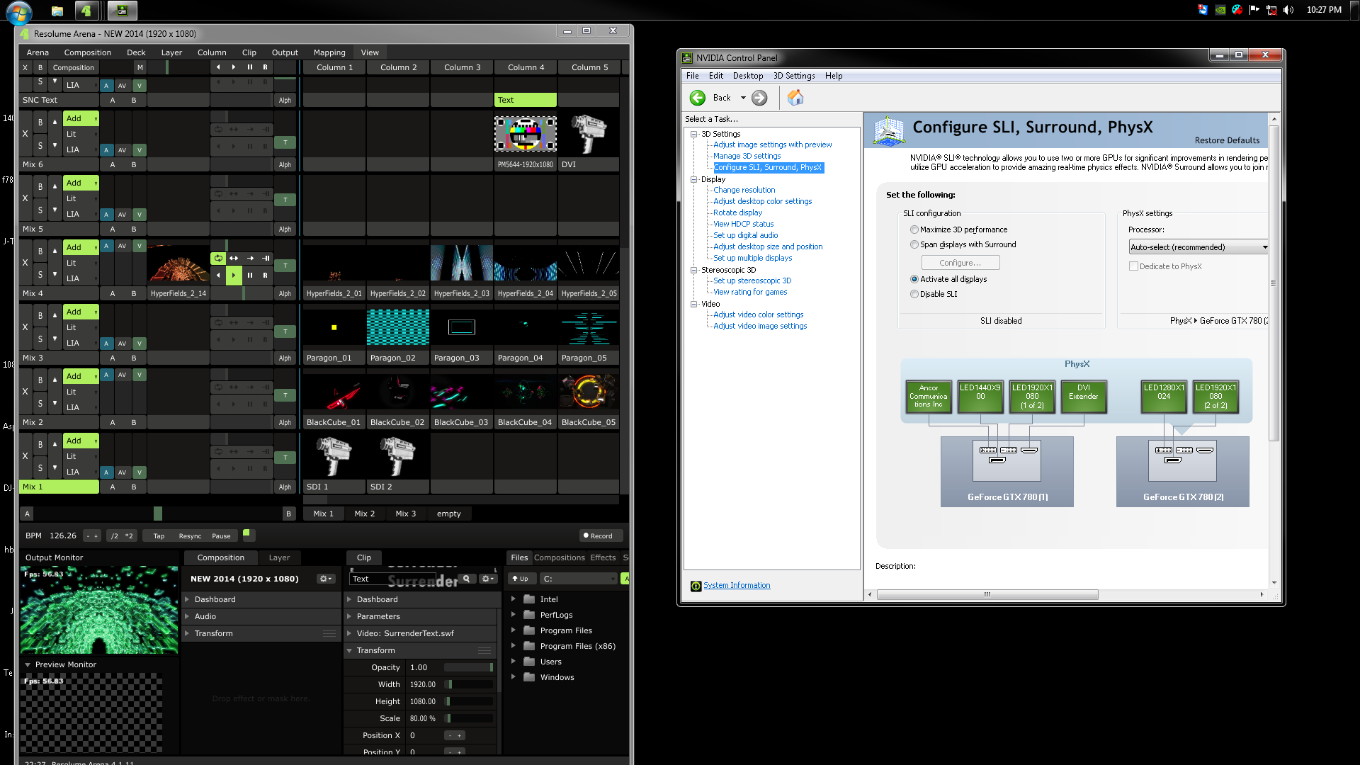

dirtyjohn_lv
Posts: 388
Location: Las Vegas, NV
Re: 2 GTX 780
Post by dirtyjohn_lv »
Here's a screenshot of my main system. SLI turned on with "Activate all displays". If I turn on Manage 3D, it behaves the way documented and you describe (only 1 output). Driver version 344.11
You can see Arena running ~60fps, with 1 video running (varies between 56 and 62)
